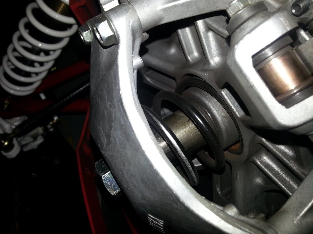

Anyone tried the old school comet lube on the pockets?

Hummmm, what does this mean?

I am no expert by any means, but I would say it looks similar to mine. I was told it's not coil bind per se if paint is missing on the outside of coils vs inside. Definitely rubbing, though. NOS-PRO, shagman, and Cannondale can tell you more. I would definitely get rid of the stock primary spring if it were me. Too long imo.Hummmm, what does this mean?View attachment 127333

That's what our 2 look like.Hummmm, what does this mean?View attachment 127333

I have seen a ton of these now and my theory is....#1 the spring is too long, #2 the spring either has a hard spot from heat treating or a soft spot that is causing this spring to not compress in a straight motion. Think about putting a spacer in a coil spring on a car or truck....one side only. The spring will compress and bend making marks on the shock and spring.
When a spring breaks, like the secondary springs were breaking all the time....it was in the same spot.
I am betting all the primary springs that have broke are in the same area also.
Working in a machine shop and the difference with all types of metals, heat treating, shot peening, hardness tests and certs.... I was happy to hear that Thunder Products uses a special wire, shot peening, heat treating process that their springs will not only last, but won't break. Haven't heard of a primary spring of theirs breaking yet.

It's scraped on the outer edge meaning it was rubbing. My belt also went down some on secondary, 2mm below???Hummmm, what does this mean?View attachment 127333

So whats causing this?Hummmm, what does this mean?View attachment 127333

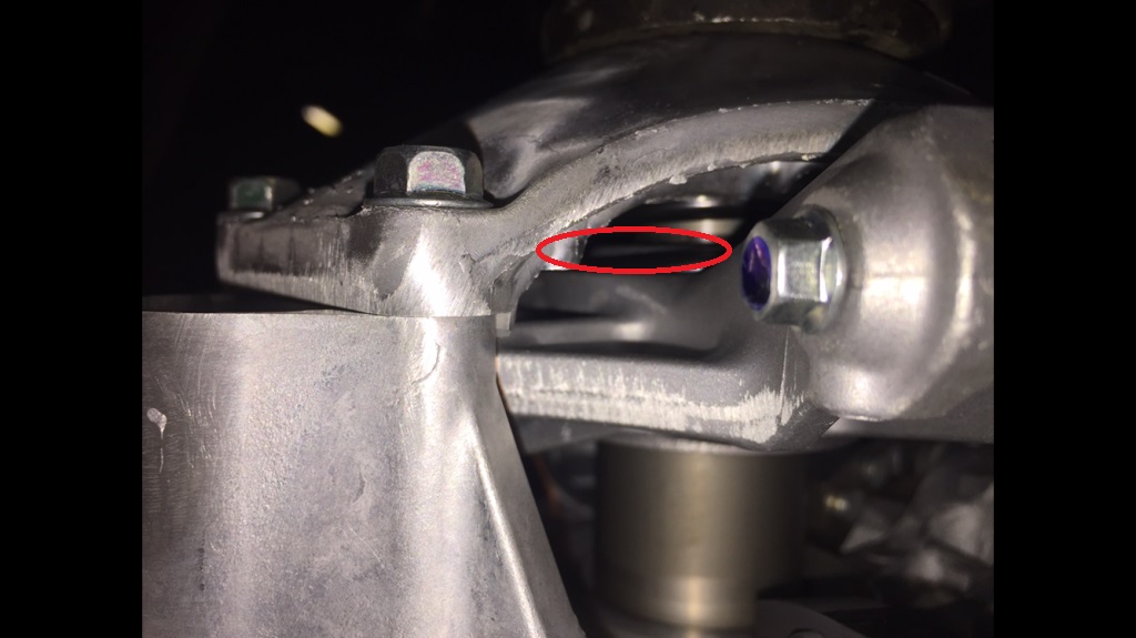

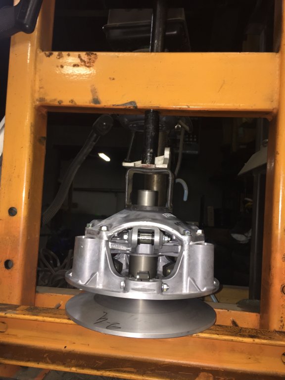

If you look at the pic that dgjr636 posted there is nothing near the center of travel for the spring to hit. So for some of these springs to show wear almost halfway up it must mean the spring is compressing unevenly. More at top than the bottom or opposite. Kind of like a dual rate spring but these are not supposed to be.View attachment 127290 View attachment 127289 FYI. Stock primary springs are not to long and coil binding. With the clutch completely compressesed there is still a fair amount of space between the coils. Not sure what is causing the spring and spring pocket damage maybe twist bind and spring pushing out sideways when compressed.
Pics of collapsed clutch. Hope you can seen there is still space between the coils.

this is exactly how the spring looks when the clutch is run up in rpms see nos pros picture
It makes sense that it's distorting because of a soft spot or even whole section like Nos said. Would also account for some having low Rpms. Soft spring will shift out further and sooner.

Can it be that as it compresses and sinks into the pocket on the spider, on full compression (shift out ) its rubbing because its squished and got fat in the middle, since that would be the area of most flex ? Pull the clutch apart and look in the spider pocket and see if it has matching rub marks. Bet it does.
Those pics all show that is the case but its so much closer to middle of spring that it has to be more than that going on. Some of these pics that show wear the spots its worn should never be in the pocket ever. Only explanation for that is that the spring is not compressing evenly over its entire length. It has to be compressing more on one end or the other.Can it be that as it compresses and sinks into the pocket on the spider, on full compression (shift out ) its rubbing because its squished and got fat in the middle, since that would be the area of most flex ? Pull the clutch apart and look in the spider pocket and see if it has matching rub marks. Bet it does.
Dgjr's pic of a fully compressed clutch. Area in red is worn and is out of the pocket. I would say any spring worn further up on one end than the other and low rpm issues. Get a new spring.
