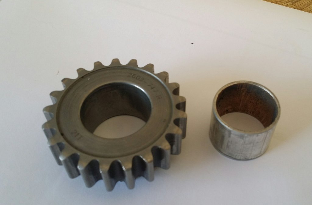

Easy to replace bushing

where can you get the bushing? For me the replace top 21 T gear in Canada it $100. What is the inside and out side D of the bushing?

where you getting the bushing?

Stock Cat bushing is GGB (Garlock bearings) 16DU14. You can also buy 16DU16 and cut length 1 mm.
SKF bushing is PCZ 1616E but you needs cut length 1 mm.
FAG bushing EGBZ 1614-E40
https://www.skf.com/group/products/...ips/table-bushings/index.html?designation=PCZ 1616 E
