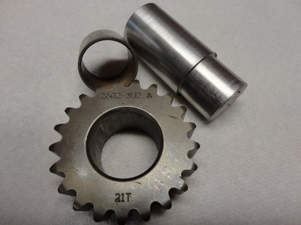

Bought one from Taylor or someone. Now I just buy whole gear and drive it out and install in my 25t gear. Made a aluminum stepped driver. Works like charm and whole gear is cheaper than bushing. Someone said old cats offered it separate need to look into that.Where does one locate these bushings?

You must be buying a stock Yamaha gear and getting the bushing put of that I assume, because the gears I priced out are 199 for just the top gear
Right. Actually a Cat gear. Asked them for the cheapest gear. I believe I pay about $20.You must be buying a stock Yamaha gear and getting the bushing put of that I assume, because the gears I priced out are 199 for just the top gear
Here is pic of gear and driver I use to remove and install bushing. Along with one I took out last spring.

Do you have the dimensions of that bushing? I might try to source a different one......
Only ones I have are wore Stain. OD is 1.125in ID1.003 length .875Do you have the dimensions of that bushing? I might try to source a different one......

I have found a few sources for bronze bushings of this size, I wonder if they would last longer?
I dont believe so. Its not really the coating being gone thats the issue its the tapered wear in the bronze under it. Coating being gone is just a good indicator the wear is there. I was thinking a DLC coated bushing but every once in a while a soft shaft shows up and that DLC might dig into it.I have found a few sources for bronze bushings of this size, I wonder if they would last longer?
