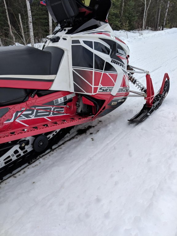

Don't worry about it, drive it till she blows.
This is mine 18hrs ago 91km on start of 3 day trip.
45km tow to get back to where we could pick up with trailer.

At the dealer today to see what happened, but something let go inside and split the bottom of the case open and also took out the sight glass.Sight glass or oil tank seal?

Your tensioner roller wheel came off from screws falling out catastrophic failure. Mine split too, where roller wheel fell and got wedged.At the dealer today to see what happened, but something let go inside and split the bottom of the case open and also took out the sight glass.
OR your sight glass fell inward and lost oil causing catastrophic failure.
BE SURE YOUR DEALER TACK WELDS THE TWO SCREWS ON NEW ROLLER WHEEL!

Exactly what happened...screws came out from Tension roller. All getting fixed under warranty other than loss of trip. I will tell him about the weld.
Were you in QC this past weekend? Saw some one with graphics like yours. Had just broken chain case. I stopped to help but said he was ok.
