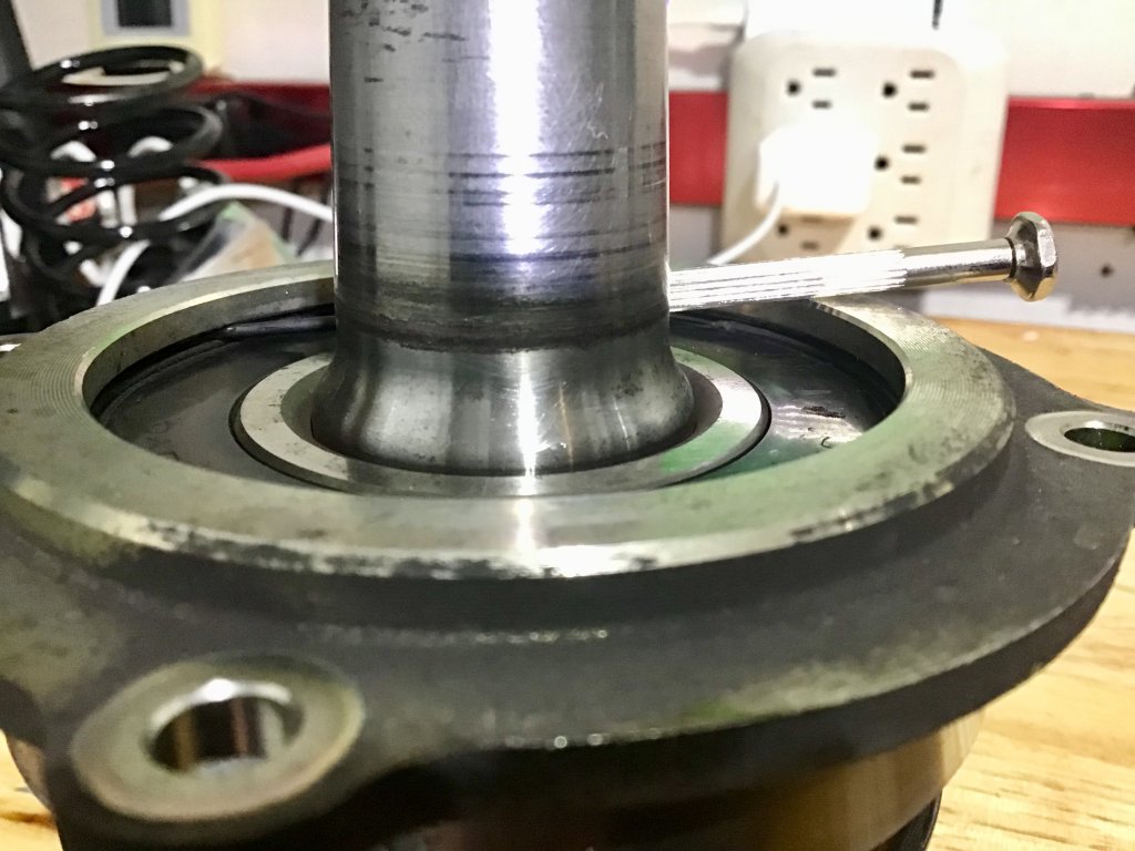

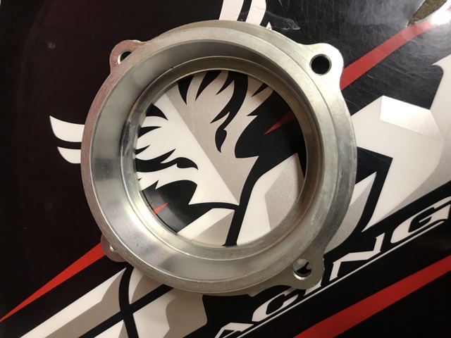

To add to my original question... The key on the crank shaft, will it fall out when I pull the stub shaft? Is there any way to tell the position of the key so I can have it sitting on the top, so it is easier to re-install the shaft? Also, have you ever seen where the shaft has moved on the bearing or is it mostly the bearing moving on the housing? Also, did you remove the stub shaft from the bearing or just the bearing from the housing and leave the shaft and bearing assembled. If the bearing gets destroyed while trying to remove, what is the part number for a new one.. Thanks..

No key to fall out, only indexing of crank and stub you cant mess it up, can leave bearing on stub if good and has not moved on stub, you will see if it has moved away from end of stub, pretty hard to wreck bearing if you use a bearing seperator with the press, press stub shaft out of bearing tetaining housing with bearing on it, put back together with green locktite, #280,243, 224 i believe are some of the locktite #s i used #280 in the housing and stub to bearing( new bearing for me) posted bearing number earlier in post for a less clearance type.To add to my original question... The key on the crank shaft, will it fall out when I pull the stub shaft? Is there any way to tell the position of the key so I can have it sitting on the top, so it is easier to re-install the shaft? Also, have you ever seen where the shaft has moved on the bearing or is it mostly the bearing moving on the housing? Also, did you remove the stub shaft from the bearing or just the bearing from the housing and leave the shaft and bearing assembled. If the bearing gets destroyed while trying to remove, what is the part number for a new one.. Thanks..

Is it not?? Im not a bearing expert, had stock one in hand when i went searching for a replacement, was talking with parts man at bearing supply house and i said i wanted a tighter less slop bearing, the skf in picture is what he handed me two of, installed them both..no more side to side "slop" and less clutch chatter. If im wrong im sorry not trying to miss lead anybody, just trying to help out a fellow snowmobiler, merry christmas to all.Tighter clearance where ?

If you had side to side slop that bearing was pooched. I think both stock and the skf one are both C3 bearings . I'm no bearing expert either but if there is indeed a better bearing readily available I'm all for itIs it not?? Im not a bearing expert, had stock one in hand when i went searching for a replacement, was talking with parts man at bearing supply house and i said i wanted a tighter less slop bearing, the skf in picture is what he handed me two of, installed them both..no more side to side "slop" and less clutch chatter. If im wrong im sorry not trying to miss lead anybody, just trying to help out a fellow snowmobiler, merry christmas to all.

"C3" means looser than standard internal clearance inside bearing. Don't confuse that with bearing ID or OD. The ID and OD and width are always same for all 6307 size bearings. C3 internal clearances are typically used for applications where the bearing is subjected to high heat, high RPM, or a bearing that is fit to shaft or housing with high amount of press fit. High heat causes reduction in internal clearance in bearing due to expansion of raceways and balls. High interference press fit uses up internal clearance essentially by expanding the ID and/or compressing the OD putting these two closer together.
A bearing with no "C3" indication has standard internal clearance which would be less than a bearing marked "C3". One needs to be careful about using a standard bearing in place of a C3 bearing because if the conditions are such that all the internal clearance of the bearing gets used up (press fit, heat) then the bearing will have what's called radial preload and it will fail pdq.
I don't think we can find out what Yamaha's design specs were for this bearing but my guess would be careful and purposeful engineering thought went into deciding to use a C3 bearing. My guess would be that they wouldn't have used C3 if a standard bearing would work under all conditions. However, I think guys have used a standard 6307 and it seemed to work. Again, the design decision to use C3 comes from calculations and not necessarily lots of testing.
