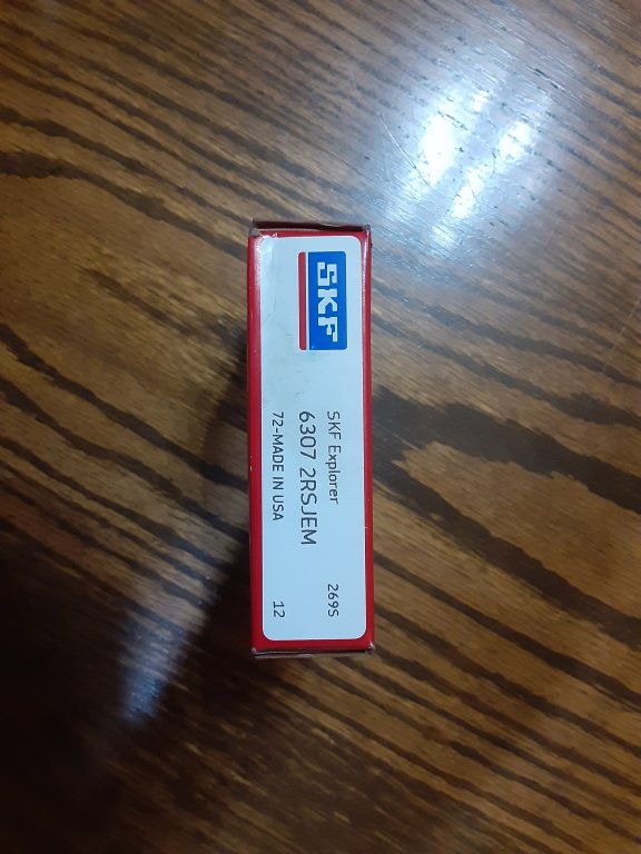

Stub shaft has a flat inside on splines that lines up with crankshaft as i remember, press bearing onto stub shaft tight, then press stub shaft assembly into retaining housing flush towards clutch side, i used green bearing retaining compound on both inside and outside of bearing. Also i uesed this bearing which is much tighter on tolerance than oem. This bearing took away much of the sidewinder clutch rattle or chatter we hear, bearing supplier said its good to 10000 rpm and grease was in temp range of what i figured the clutch area would see.

Really? That would be pretty cool. You may have just found a cure to a source of frustration here on these forums that has been around since the 3cylinder 4stroke came out.bearing took away much of the sidewinder clutch rattle or chatter we hear
I wonder if the weight of that bearing is more than the stocker.
where did you order it?

Went to my local bearing supply house we went thru some of his bearings on hand, china, japan, and i settled on the skf made in america!! Cost me about 40 bucks a piece, installed one in my cat 9000 and one in my sidewinder, night and day diffrence in clutch chatter for me, wrked well so far, all last season and one trip this season. Oh ya he had these in stock on shelf so they should be common.Really? That would be pretty cool. You may have just found a cure to a source of frustration here on these forums that has been around since the 3cylinder 4stroke came out.
RAMSOMAIR
Please post manufacturer and part number
