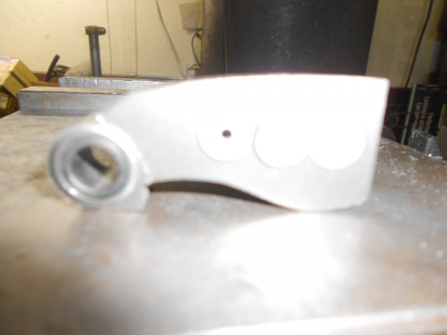

![08weight1[1].jpg 08weight1[1].jpg](https://ty4stroke.com/data/attachments/57/57179-9c2255eb4cfdf86711ab19f46917a2a8.jpg?hash=nCJV60z9-G)
Stingray what are you referring to when u say "our setup"? Is it what you're using on your sled or nospro sled? Last I ever knew was u were running stock helix, nospro, if I remember right is using a multi angle helix. Nospro is running 8fp weights? You're running 8fs? If this is so then the similarity in your setups is that you're running primary shims, but they're also different. Do you really feel that in a drag race your personal set up with flat profile weights and stock helix well beat a set up that's using aggressive profile weights and a multi angled helix that is more aggressive they are in stock? If this were true then I'm sure every single clutch vendor would be selling primary shims. I have yet to see any.
Barry, I have made it VERY clear in my posts that the heart of this is the primary clutch spring shim. Everything else helps but the heart of this is what matters. Next, an aggressive curved profile forces a quicker upshift, shift your car too fast and see if that works. Why do you think Yamaha came out with the flat profile 8fs and put it in 4 strokes? Yamaha has long had weak secondary issues, we used to (and still do in parking lots to help people) wind the secondary way tight on a Mountain Max to make a big positive difference. Both my boosted Phazers had to get roller secondary's to work right (SRX or Mountain Max secondary, IE) because the power forced early upshift on the stock secondary and bogged them down. Have to give credit for Cannondale to getting me on that path with the Phazer secondary. Thanks Cannondale!
Look at the 8fs and 8fp weights in the picture above
Now for the other part, I have been doing clutches for decades and until now all I ever saw a primary clutch spring shim do is raise engagement speed and a little on top but no real performance increase other than higher engagement speed for take off. BUT this Viper clutching setup is different. One vendor I know of who has done clutches for decades is using smaller rollers with other tweaks. If I cared I could experiment with that but I do not care to waste any more riding time testing. I have what works and why spend time trying to simplify it so I can bring it here to be bashed?
As NOS-PRO has said we don't make a dime out of this in fact I just answered another private message (and am glad too). More than a few of you I have talked to via phone and discussed clutch issues in detail. Always happy to help. Barry I am going to private message you my phone number and if you have a question lets talk about it person to person as this "drama" as it was said to me in PM isn't helping anybody.
I do not have an other than professional relationship with the vendors I recommend and sometimes wonder if those attached to a vendor via job or relatives would not be better if they stated so.

stingray719
I was just informed by a very reliable source and after doing a quick search of my own found out the stock 8gl viper weight is the same weight that's been used in the nytro since 2008. My source claimed "the 8gl is in no way a 2-stroke weight, the initial hump is to increase corner to corner acceleration" sounds like it's prolly the type of weight 90% of riders are looking for.
Once again, the bump is at the heel look at the pic and see where it actually works which is at takeoff and unless you stop when going corner to corner that is not correct. 2 stroke weights historically rev at take off to make up for a lack of torque which is why I and others call it a 2 stroke weight because of the profile. Look at the chart that is pictured and see where clamping tapers off on the 8gl...ergo the hunting for rpm the stock clutch is noted for. Note the flatter curve on the 8fp. I ground the heel down on a set of 8gl just to test and it took most of the rev limiter out at take off, just as a test for myself I do not recommend this.
Note the machines the 8fs flat profile comes in.

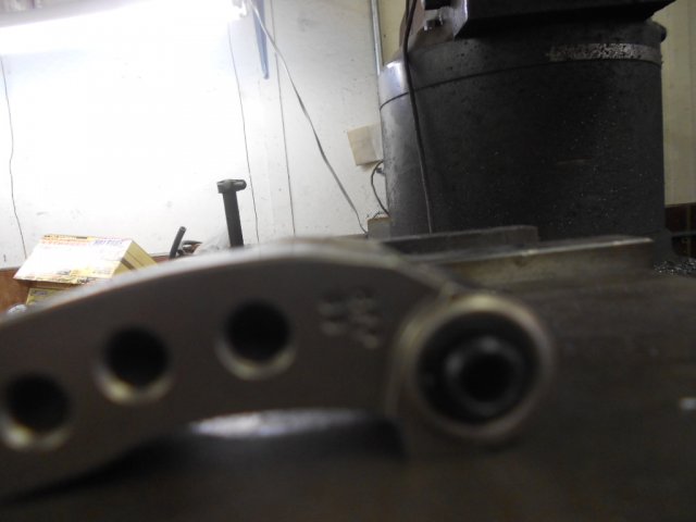

Also, how can you tell that the 8GL weight "lets the engine rev" at take off or has less belt grab, I understand, maybe in your situation out in the field you felt it was that way, but was your primary spring possibly not correct? Helix selection not correct? The Yamaha chart lists the 8FP at about 450 kgf at approximately 8mm of stroke and about 320 kgf at full stroke of 30mm. The 8GL has no numbers on it's graph, but looking at the graph, it shows that it has more of a straight up (belt grabbing) graph than the 8FP or 8FS weight at the initial.
The 8FP weight has a hump/bump at the heel as well, just before the weight engages (the roller has to go over this hump/bump right at or slightly after engagement) just like it has to on the 8GL. Now the 8GL weight is approximately .020" higher hump/bump than the 8FP weight. That hump/bump applies more initial belt grab (look at the graphs, you can see the graph spike at the beginning and then slowly go down).
If you want a flat profile weight, then you better try the 8HG!
