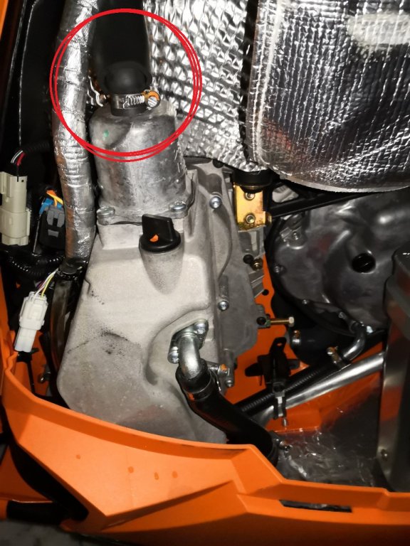

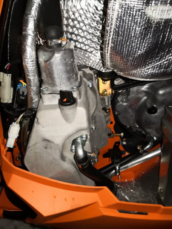

Hey,
So today I rolled over on the right side, was almost a total flip, I pulled the cord so the engine shut about 3sec after roll/flip.
Turned sled upright, and took a smoke break (5min)
When I started the sled I had "SD 30" Alarm flashing at me (oil pressure reduction) , I took my friends dare and drove home as I was close by 500m ish.
The sled was behaving all normal driving home and no shutdowns, also idles fine.
I read that I can have an airlock? I have my sled tilted on the left side now and will se tomorrow if the code is gone.
Question 1: Does the code clear by itself when oil pressure gets right, or do I have to clear it myself and see if alarm code comes back after initial fix?
Question 2: Can someone show me the oil return line? I read somewhere here that I can unplug the return line to prime the pump.
I don't know much about stuff under the hood so I'm posting some pictures of the oil tank hoping someone can point out the return line so I can try that fix.
If I somehow didn't get the oil return line in the picture, feel free to post one if you have.

Try and take the tank vent off and plug the top of the tank vent with your finger actually building a bit of pressure on the tank. This primes the pump. Don't do it for too long, just long enough for the warning to clear. I've never had it happen, but have heard you have to let it pressurize to prime the pump.

Hey,Try and take the tank vent off and plug the top of the tank vent with your finger actually building a bit of pressure on the tank. This primes the pump. Don't do it for too long, just long enough for the warning to clear. I've never had it happen, but have heard you have to let it pressurize to prime the pump.
Thank you for the tip, I will try this tomorrow and let you know.
Is it this hose you mention? (circled in red)

Yes thats it. Take the hose off and plug the tank with your thumb with it running, you will feel and hear the pressure build, but not too long because it will blow the tank seal if the pressure gets too high, see if the oil pressure light goes off.

Tried this but didn't do anything to the code.Yes thats it. Take the hose off and plug the tank with your thumb with it running, you will feel and hear the pressure build, but not too long because it will blow the tank seal if the pressure gets too high, see if the oil pressure light goes off.
The oil pressure light never came/comes on while engine runs- its only on before I crank the engine over, when engine starts running the oil light turns off within 2 seconds.
We are now in the process of fitting an actual pressure gauge to see if it has any pressure.
So If I have oil pressure we will try to force a simple error code to show and se if that code goes away after we fix it.
Water temp should be easy to make throw a Code SD 21. Time will tell
