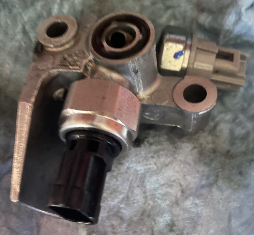

I ended up removing the whole block by the two bolts and doing it on the bench. I didn’t have a deep socket with me that fit, wasn’t even sure if there was going to be room in there to use it but must be if you’s have done before. Looks like a 15/16 socket, or maybe 23mm….
Anyway hopefully I hadn’t caused any problems by completely removing the block.

Anyone know the torque for the two bolts that hold this on? I have the service manual from the dealer but haven’t found this part yet.I ended up removing the whole block by the two bolts and doing it on the bench. I didn’t have a deep socket with me that fit, wasn’t even sure if there was going to be room in there to use it but must be if you’s have done before. Looks like a 15/16 socket, or maybe 23mm….

On page 56 in 2017 Sidewinder Service Manual - 8.7 ft. lbs.
shawnj
Okay thanks. I check page 56 of my manual and it’s about cylinder and crankcase.On page 56 in 2017 Sidewinder Service Manual - 8.7 ft. lbs.
I already installed it and did it to what I felt comfortable without stripping (likely too way too tight tho).
