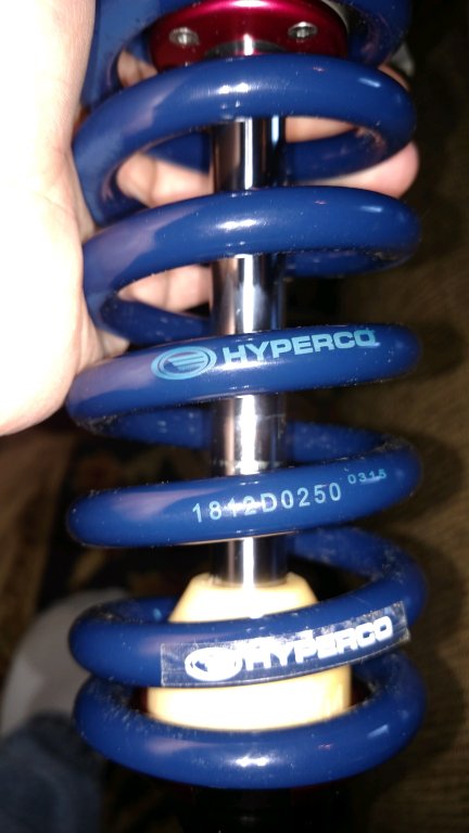

Here is the spring I have on our elka stage 4 shock.
Accelerated Technologies did a full service on my shock last year so they have all the info on it.

This is on a 146.Will a stage 4 shock fit on a 2016-2018 apex or vector. There is not a lot of room between the support bars on either side of the shock. I see they sell the stage 2 for the 2016-2018 apex or vector. What makes the stage 4 better.
Had to space out the relay rods so they would clear the spring and reservoir. The reservoir is offset so it will clear the grease fitting on lower shaft.
The stage 4 has compression and rebound adjustments plus reservoir.
Buy looking at your picture I cannot see the 2 innner wheels by the lower shock mount. Does the 146 have these wheel there. When you buy the ELKA shock stage 2 does it come with larger spacers to make room for the spring.This is on a 146.
