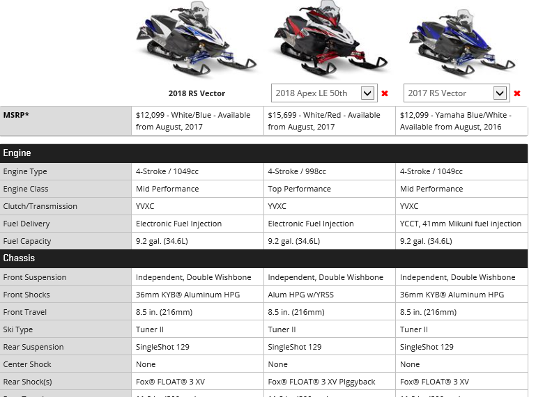

TrueBlue - The part number for the new Fox Float XV Piggyback shock you are referring to is 8LB-47480-00-00. The program you are referring to in regards to Yamaha paying for an upgraded shock with the customer paying for the labor to install it can be found in the pdf file attached at the very end of this post . Note the upgrade letter is aimed at 2017 Apex owners and has never been officially released for any other models. I have also attached a pdf of a Tech Exchange that Yamaha released with info on the new 8LB rear shock. It contains info on it being available as an accessory to fit 2016-2017 Vector/Apex models along with install and set-up information on the shock for both 129" and 146" singleshot suspensions.
In regards to 2018 Vectors they will not have the new Fox Float XV Piggyback style shock in them and will be using the same Fox Float XV shock like the 2016-2017 models have used. The only 2018 models coming with the Fox Float XV Piggyback shock are the power surge 2018 Apex LE models. Take a look at the pic below with the model comparison info for 2017/2018 Vector and 2018 Vector and in the rear suspension area you will see the shock specification for each sled. If you are spring power surge ordering a 2018 Vector and are getting the $600 accessory credit with the power surge deal one thought would be you could put it towards getting that rear shock as currently as an accessory it retails for $499.99 - hope this info helps!

Kevin, thank you for all that information, it was very nice of you to do that write up for me. If you want answers this is the man to answer them, thank's again.
