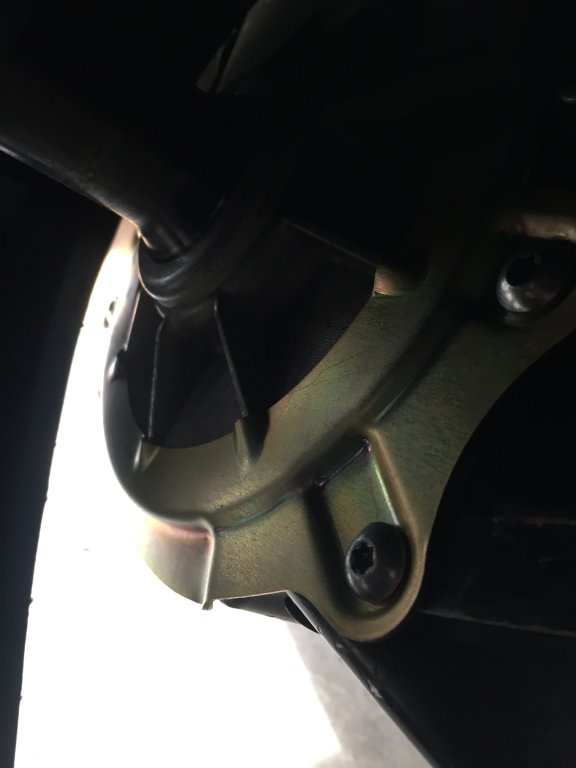

Maybe add the Xcr chain case brace to the new inner chain case housing. Artic Cat part# 1607-306

My local dealer in the Lehigh Valley can't even look at it till 2/12, So taking it down to F&S Yamaha in Hanover Pa. tomorrow morning. I'd do this job myself, but what the hell do I even have a warranty for! I'll definitely put that brace on after the season. Hell I put everything else on it, why not that! Piston Head ,will the factory hardware work, or do I need longer bolts also?
The factory hardware works.
