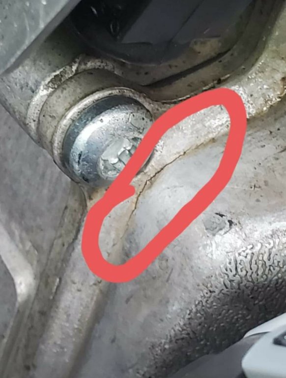

Fixed mine over the last two days. I could not use the 3mScotch Weld as planed. I left it in the garage and had froze sometime since the fall of 17 when I did the rear heat exchanger protectors. I bought Devcon brand 2500 pound epoxy at the local hardware store. Applied a liberal amount to the crack inside chain case and smoothed it out once it started to set up. Allowed 12 hrs to set and cure, added a coat of Ultra Copper RTV today and buttoned up the chain case. Getting fluid on Tuesday at the local dealer, finish the button up and run her on the stand. I hope this fix will get me thru the season.

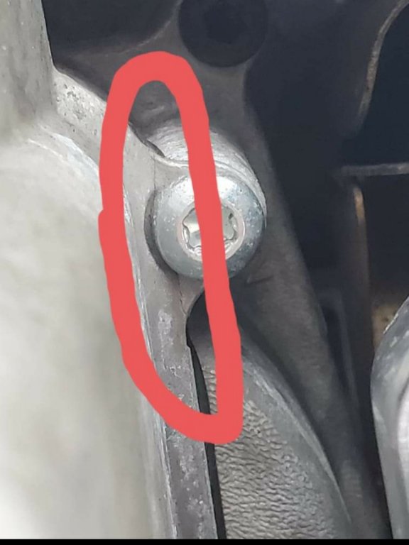

over torqued bolts?View attachment 158750 View attachment 158751

over torqued bolts?
Must be?? sled is a 2020 and had 600km . Oil tank has never been openedover torqued bolts?

Tank never opened? That changes things a little.. Could be something from factory.. Or even a casting issue with this magnesium.. Obviously they have issues with it..Must be?? sled is a 2020 and had 600km . Oil tank has never been opened

Devcon is some really good stuff. We used to use it to repair chutes at the cement plant. Case is junk. Too thin, garbage material and a lot of flexing. Needs to be aluminum not magnesium.

Buttoned up the chain case, filled with 16ozs. of fluid and ran on the stand. No leaks. I didn't put the back inside rivet on the lower plastic cover due to the fact it was tight against the inner case. ( Good design Cat) I've got a week long trip in Maine from 2/6 so that will tell the tale. I'm taking a bottle of chain case fluid with just in case!!!

Great news. Hope it holds for you. I did a JB weld on mine. It was only a slight weep from a casting imperfection. Mine is holding. Sat in a trailer at -5 the other night. Got about 250 miles on and it’s holding oil. No leaks. I did put a layer of high temp silicon over the JB.Buttoned up the chain case, filled with 16ozs. of fluid and ran on the stand. No leaks. I didn't put the back inside rivet on the lower plastic cover due to the fact it was tight against the inner case. ( Good design Cat) I've got a week long trip in Maine from 2/6 so that will tell the tale. I'm taking a bottle of chain case fluid with just in case!!!

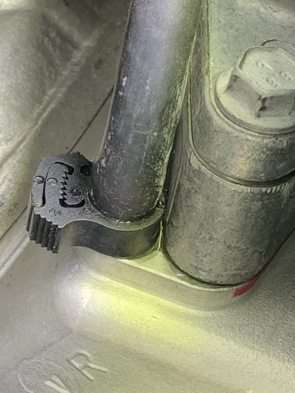

How free flowing would anybody think the breather tube on the chaincase should be and if it was plugged what would be the weakest leak point

You over fill the case it will come out that breather tube. I would say it’s as free as can be ?
