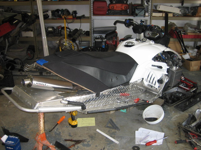

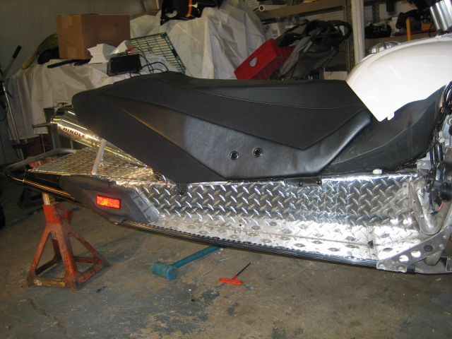

Here is a link on what I am doing with Apex mountain tunnel (pics at the end of the page). :
http://www.ty4stroke.com/viewtopic.php?t=72949&postdays=0&postorder=asc&start=0

My VE-style tunnel is not build to sell. You could build yourself the same tunnel - I have the CAD files - it is not hard
