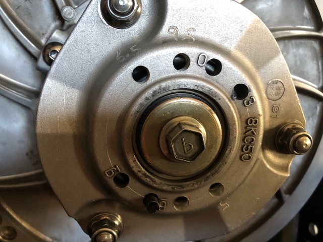

Thanks Mike. Any chance you can tell me how I get 95 twist on that black/ orange? I think I’m going to stick with the 90 on the back/orange unless my heat gun tells me differently. But I thought I saw you had drilled another hole in helix for the 95 twist. I’m guessing I might need that little extra. I hate to drill out helix wrong or mess it up.

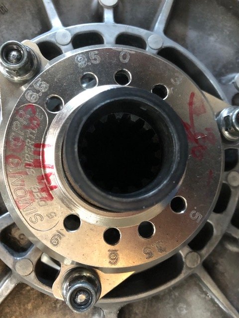

The added holes need to be drilled into your helix. Like this Jon. I copied an old Simons CPR helix that was already built like this.
