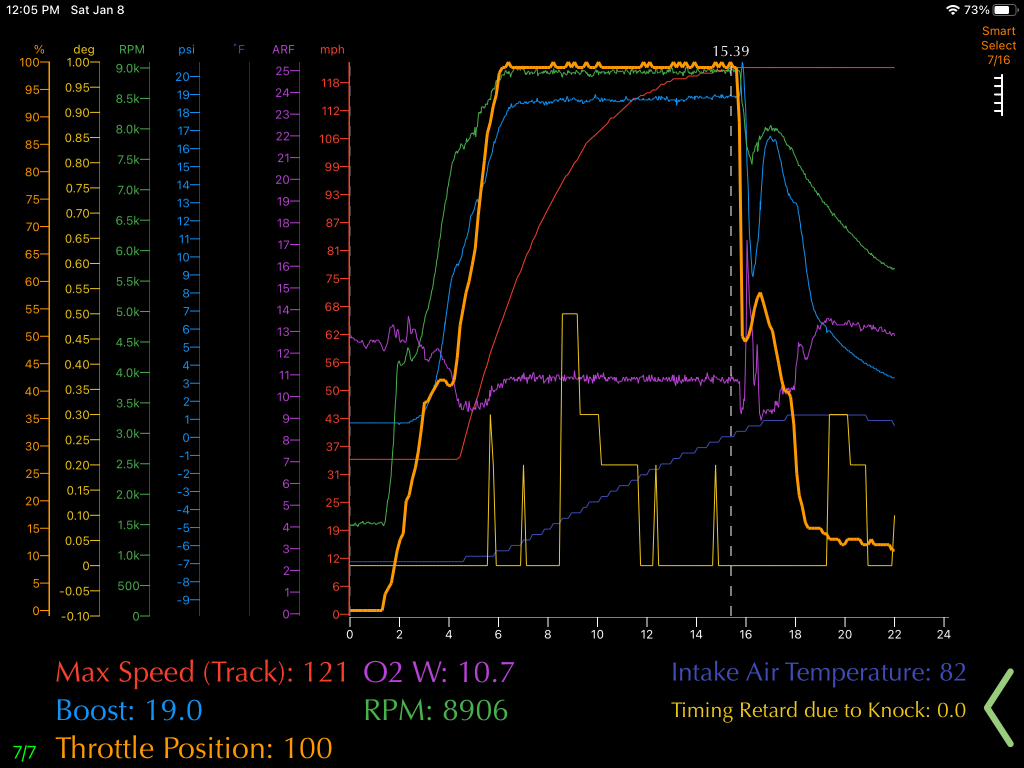

Got a chance to run it today. A little warmer out at 22 degrees. I added 6oz of Boostane and it seemed to make a difference, but still a little timing being pulled. You can see it didn't pull timing for as long though, so maybe this is quite a bit better with the added octane.
Got to use the Dragy on this run. I'll post those times as well.

If I were doing this I would try to be smoother on the throttle (on and off). No blipping. The big chunk of time under WOT where it is still pulling timing looks like its still not quite happy but I have no feel for what 'normal' looks like in a well tuned engine. One way to look at it is that for the 'run' of approximately 10-11 seconds approximately 30% of it happens with the timing being pulled. But again, I am a data guy, not a tuner so maybe someone could post a comparison graph.

I think what you see here is just noise. .5 deg timing is all, but it last for a few seconds so that is a bit weird with that much Boostane booster in there.
Wonder why its seems so rich at 10.7. It should be averaging around 11.7 during the course of the run at WFO.
What muffler and what are you using for air intake?

I was wondering about it being rich as well. It’s upper 10’s the entire run. I run a sandale 2.5” stock modified muffler and a cai from prevost performance with the cone style k&n. I’d like to move to the 3” stock modified from td. Nice to have these logs now so if I do I’ll see how it changes things.

I'd say the muffler might be a bit restrictive perhaps, and I'm not sure about that intake, I know Hurricanes intake filter has a nice smooth flowing airhorn inside which helps with airflow and leans the A/F mixtures too. Dave selected his air filter for that reason of added airflow.

I’m guessing a muffler would lean it out but I may do the closed loop first. It’s cheaper and I’d like to see how it works on my sled. Muffler is probably next year.

Sounds like you and turboflash should trade mufflers ?? He needs lower AFR and you need higher AFR.I was wondering about it being rich as well. It’s upper 10’s the entire run. I run a sandale 2.5” stock modified muffler and a cai from prevost performance with the cone style k&n. I’d like to move to the 3” stock modified from td. Nice to have these logs now so if I do I’ll see how it changes things.

The throttle is actually wide open the entire time. It fluctuates between 99 and 100 for some reasonIf I were doing this I would try to be smoother on the throttle (on and off). No blipping. The big chunk of time under WOT where it is still pulling timing looks like its still not quite happy but I have no feel for what 'normal' looks like in a well tuned engine. One way to look at it is that for the 'run' of approximately 10-11 seconds approximately 30% of it happens with the timing being pulled. But again, I am a data guy, not a tuner so maybe someone could post a comparison graph.
