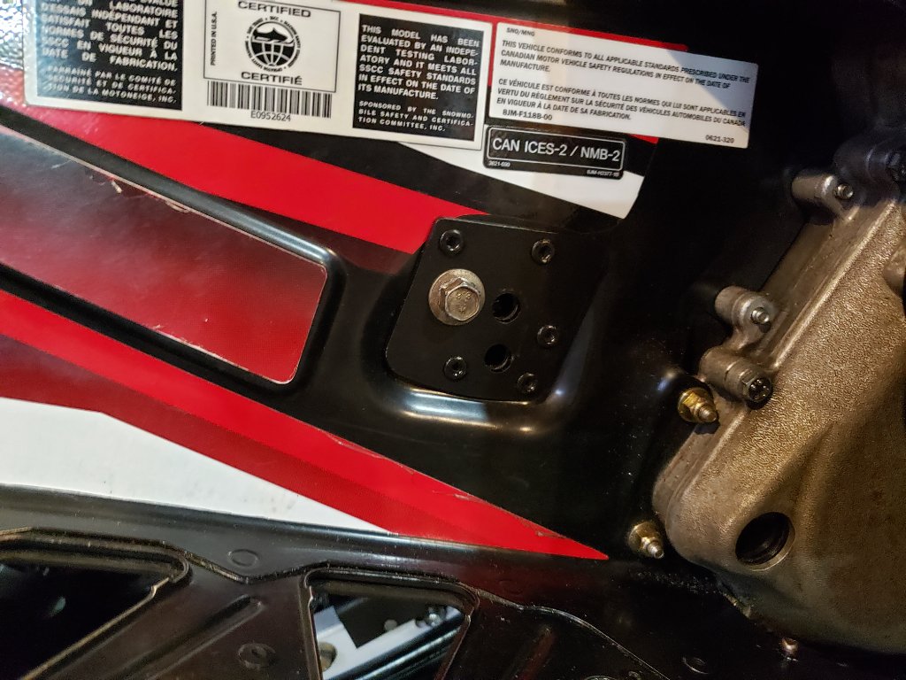

Along with doing the upgrade for cross shafts one should also installed the tunnel support plates for the cross shaft .
Barn of parts sells them.

I've always wondered about those tunnel braces and how well they actually work. The weak point in that tunnel should be the crease section that creates a stress riser just beyond those plates
Cat fixed this with the catalyst.

I heard that few times too! So i guess, even the RR require the shaft upgrades, and tunnel reinforcement!Along with doing the upgrade for cross shafts one should also installed the tunnel support plates for the cross shaft .
View attachment 178256View attachment 178257
Have not heard of any failures of tunnel damage with these plates.

Agree on the reinforcement. Have you seen the pefi solution? It’s nifty solution and looks better. I think it’s more expensive though. In the next couple of weeks I will be doing these on my two 998s as I do the spring maintenance on them
