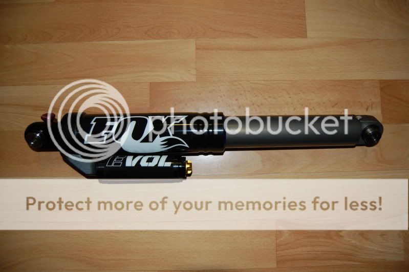

I also just received 1 of 3 shipments from OFT Racing. Dimebag just took it and ran. It was one of the Skinz Concept susp. The only thing i got out of it was my new FoxFloat EVOL`R Shock`s. They look pretty damn sweet !
