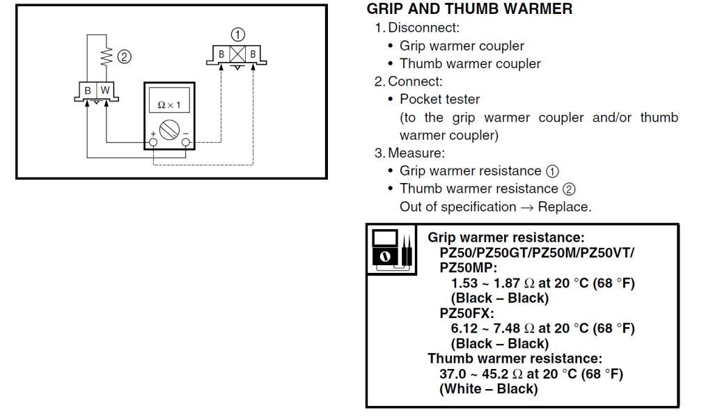

Other than that, you can check their resistances. The connectors are just down the bar on each side.

Glad to hear there is a connector below the handlebar, will check that out will also check grounds, the left works fine nothing on right side, if I recall it was not working when I purchased the sled, looking last night there is grey epoxy around the rubber handgrip but on left side nothing leads me to believe the last owned was in there,
