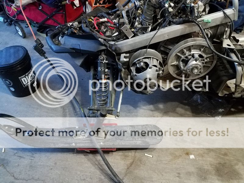

Here are the pics, I'm on board with the efi motor route, hopefully Travis has my answer
I have more pics and can take whatever you guys want to help see what I need...
I have all the plastics and body parts, plus both gas tanks and a lot of nuts, bolts, etc
Let me know what all I can post to help, anyone know if this track is stock? Seems pretty aggressive from what I've read on here...

The attack came with a 136''x 1.25'' track. Yours looks a bit bigger in the paddles.

Post more pictures of the wiring and footwells. It appears he left all the wiring in place. If so get rid of that motor and get a apex motor, no fab work and everything will plug right in.

I agree that all the electrical appears to be the stock stuff and not touched.
I'll grab some more pics of that when I'm at the garage again.
Footwells meaning where your feet go? I know there's a little radiator and fan above the right side one

Yeah checking if all the relays are in tact. If so. Dump the rx1 motor they are worth almost the same money.

I remember seeing 4 relays on the left I think. I'll confirm soon...
I was surprised at the value of both motors, hoping I can recoup by selling the rx1

It looks like a apex motor will drop right in for you. That is a good thing, I was worried he had started butchering the harness and trying to wire in the RX1 ECU.

Agreed! I was glad when he had the whole wiring harness for both carb/efi untouched!
I'm working with Travis on getting a motor currently just working out shipping arrangements now
Anyone have any input on the ski's I've got?
kinger
Those are Simmons gen 1 skis. Nice upgrade from stock

Good to know, I did some light reading on them and I'm anxious to see how they do this next winter... It's gonna be a long summer once I get this thing running!
