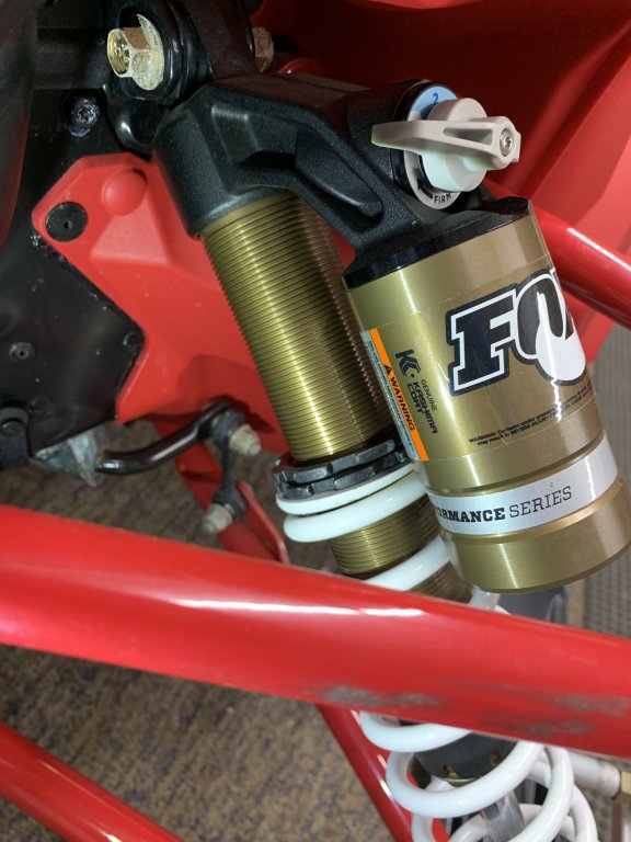

Front Track Shock … There 8 threads from top to spring retainer or 3/4 “ Limiter straps are full lenght and not shorten.. They are tight when sled is at rest just sitting there no slack… Dial on front track shock is on two ( 2 ). Rear Springs has adjustment nut set on stiffest setting . Transfer Rod in rear has had plastic blocks removed and replaced with a proper size peice of Radiator hose.. Rear shock dial is set at Two (2)

Studding on this sled is 1,575 Mega Bites interior band two (2) studs , Single Round Aluminum plates with tall aluminum nuts.. Carbide is currently 5 1/4” duel bars on Tuner ski’s . When studs hole were drilled they under size which makes for a very tight hole and less stud flex.
