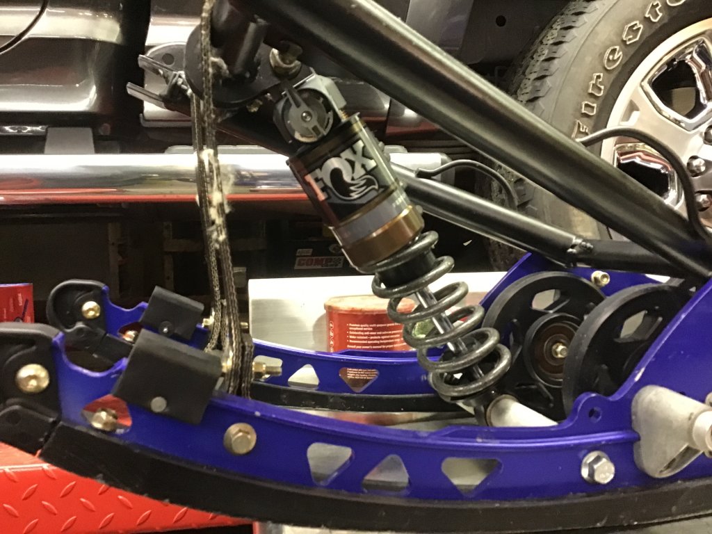

Just got these installed on my Deluxe model tonight. Just in time for the rain tomorrow. Fronts from Carver and rears from Yamaha. The sled was comfortable, but had too much give in the rough. If I set the fronts on 3, I can’t push the front down more than an inch.
You have to turn the Resi on that rear shock to the bottom so the compression adjustment it on the right side of the sled sitting on it, not the top like you have it in the picture.
AFWIW, 3 on the shocks is unusable unless you had them re-valved or weigh a whole bunch, or maybe you are like a Tucker Hibbert snow crosser I suppose.
- 5,714
- 4,312
That's right.You have to turn the Resi on that rear shock to the bottom so the compression adjustment it on the right side of the sled sitting on it, not the top like you have it in the picture.
I had one come in this year mounted like this, track wore right through the reservoir.

That's right.
I will dYou have to turn the Resi on that rear shock to the bottom so the compression adjustment it on the right side of the sled sitting on it, not the top like you have it in the picture.
the reservoir.
Thank you for the help. Easy to do yet since I haven’t put the skid in.You have to turn the Resi on that rear shock to the bottom so the compression adjustment it on the right side of the sled sitting on it, not the top like you have it in the picture.
- 5,714
- 4,312
It was Mike, I may not have noticed if he hadn't mentioned it.Thank you for the help. Easy to do yet since I haven’t put the skid in.
