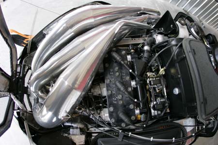

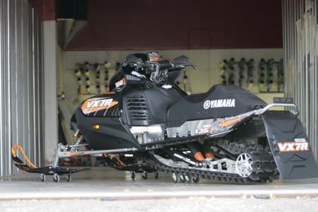

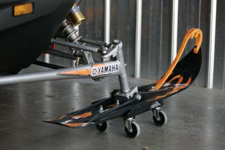

Don't mean to hi-jack this thread, but since we're talking about shocks and orange sleds let me know what you think about this sled......
View attachment 148197 View attachment 148198 View attachment 148199 View attachment 148200 View attachment 148201View attachment 148202
Back in the day I built this 2-smoke Viper with some custom long travel Ohlin's shocks/Ti springs on the front and an Expert X 136" skid with some fully adjustable KYB's with remote resi's with help from HyGear Suspensions. It also had a 780 big bore with SLP triples.
If you've ever regretted selling a sled, this would be the one that I really regret. It rode and handled awesome along with a light weight feel and a sound that only a triple/triple can give.
I wish Yamaha would give us something with these attributes once again. V-room-V-room!
I would have loved to driven that sled! After putting 9,000 plus miles on a relatively stock Viper it would have been a hoot!
