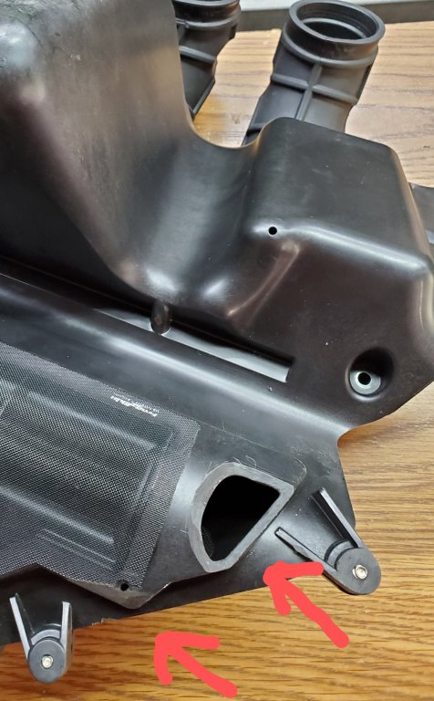

I am near completion on my Viper. The airbox does require minor modifications in two areas: a flat on one corner (screw clearance), and a "D" shaped hole just above the flat (for eps motor power plug clearance).Who has done this to Viper or 7000?
I want to know if the air box goes back in without interference.

So no interference with the radiator? That's great to hear! Was thinking about getting a 7000/Viper for my wife but only if I could do the PS upgradeI am near completion on my Viper. The airbox does require minor modifications in two areas: a flat on one corner (screw clearance), and a "D" shaped hole just above the flat (for eps motor power plug clearance).View attachment 176672

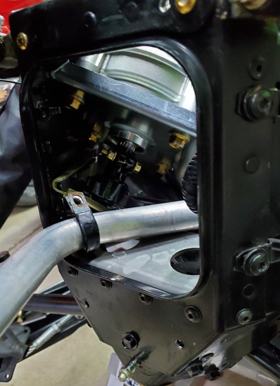

The Viper install is extremely easy, due to lots of room and the opening in the front of the bulkhead. I was able to mount the eps motor to the mounting plate & bracket, and lower the assembly into place. I did have to temporarily remove the sway bar however.So no interference with the radiator? That's great to hear! Was thinking about getting a 7000/Viper for my wife but only if I could do the PS upgrade

wow, tightening that coupler bolt was the hardest part on the turbo install! this looks easy!The Viper install is extremely easy, due to lots of room and the opening in the front of the bulkhead. I was able to mount the eps motor to the mounting plate & bracket, and lower the assembly into place. I did have to remove the sway bar however.
