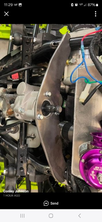

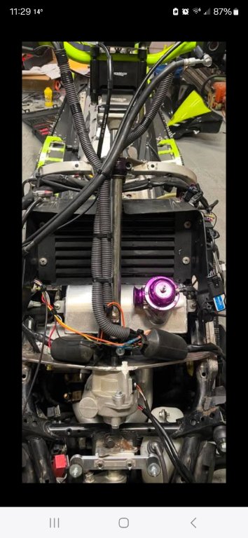

This guy did his nytro.
Maybe the vector/apex motos could work in this application also.

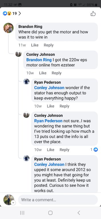

Any movement on this project?
I'm interested as well. I put a GSE Performance unit in my 2018. What a POS. Waste of money.
