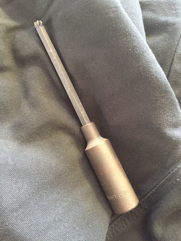

X2 - it's a toss-up between this and the C.T. Moto-Master Anti-seize as to what is the best $17 Cdn you can spend on these sleds!View attachment 141501 The T-50 ball end torx bit from the Yamaha parts catalogue inserted in a 8mm socket works amazing if one decides to use the factory torx bolts.
