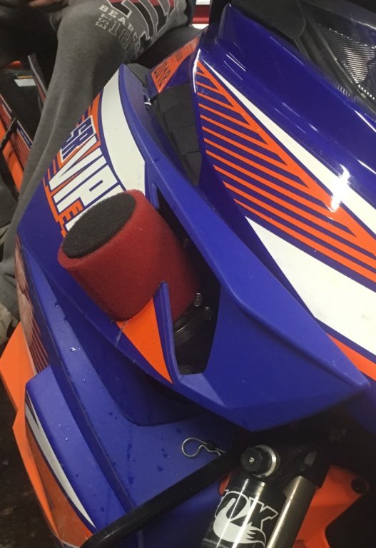

Knapp has done a lot of testing on this. I think he said the out the hood(external) is the best and coldest, but the mapping needs to be adjusted. The under hood CAI flows more but does not lower temps.Stock intake better on colder intake temperature, external intake hotter, search IAT above read, many tests done.

Tommcat has done a bunch of dyno testing with the external intake. There were gains to be had and cooler intake temps, but the AFR did go up.

I like the turbo noise and the look personally. Seems like lowering the temperature that much would be a huge bonus. My sled reads what I consider to be fairly hot with the stock air box. I seen 70* on a 35-40* day

Not the case with my external intake. I dropped from 70 degrees to 45 degrees just by sucking outside air. When 30 degrees outside
