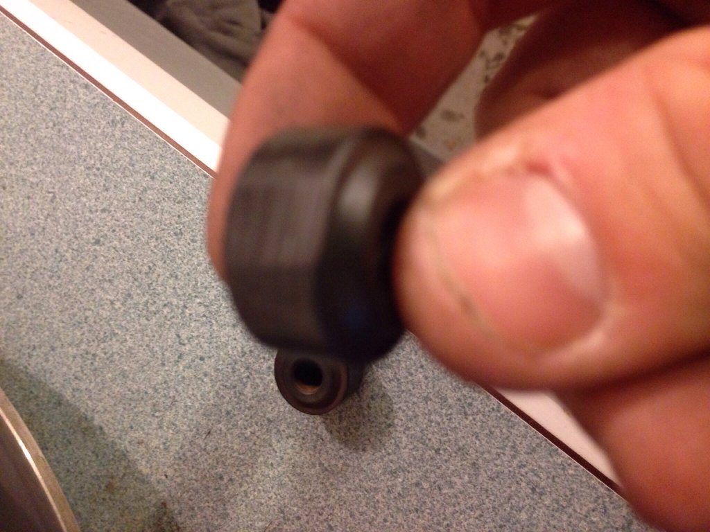

one flat roller that has started to mark the helix

My dealer said yesterday that Yamaha "is not aware of any issue with the rollers" at this point. WTF? He is getting me new yammy rollers, and the cat ones are b/o till end of march. Even though at rest I have at least one roller not touching, I have full wear marks all the way up all 3 of the ramps on the helix. Maybe once everything starts spinning it balances out?

I installed the cat rollers, osp adjuster, and 8DN belt over the weekend. Only one of the stock ones had flat spots. Checking the cat rollers once I got home, I noticed that all 3 were in contact with the ramps.

This is probably a dumb question, but how do you find out if there's a flat spot, other than by actually taking the roller out? I have peeked at my secondary a couple of times, but haven't actually removed it. Looking at the helix, there are wear marks on all of the ramps. So, I know contact is being made. What else should I be looking for?

You can reach in and spin themThis is probably a dumb question, but how do you find out if there's a flat spot, other than by actually taking the roller out? .

Hit them with a bright light and spin them > look for flat spots. If your really LUCKY you wont be able to spin them at all.. LOL

Interesting. I was wondering if I should be able to spin them. Because the ones in the primary spin freely and am used to seeing that on my other sleds. Actually, last week (prior to my most recent ride) when I tried spinning them on the secondary, none of them did. Wasn't sure if that was good or bad. And as I said before, all ramps had marks on them.Hit them with a bright light and spin them > look for flat spots. If your really LUCKY you wont be able to spin them at all.. LOL
