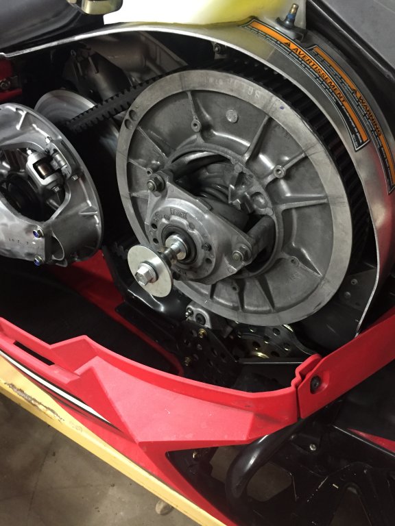

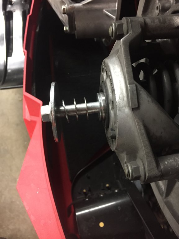

So I don't want be in a jam if rollers take a while to get. What I did was took the secondary off my Nytro, put on the Sidewinder and fits perfect, added 3 washers to the bolt to space the large washer away from the secondary to allow some movement on the shaft like the "Yamaha" sled have. Hope to get out Sunday to try it.
