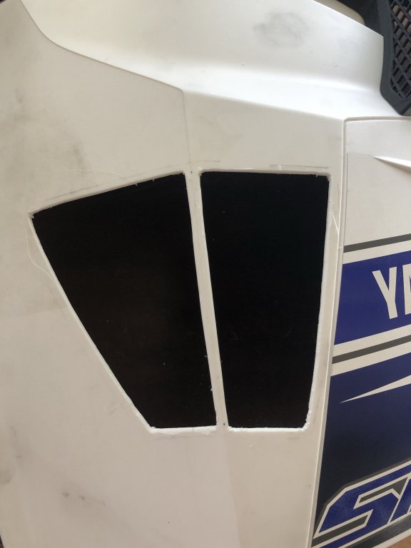

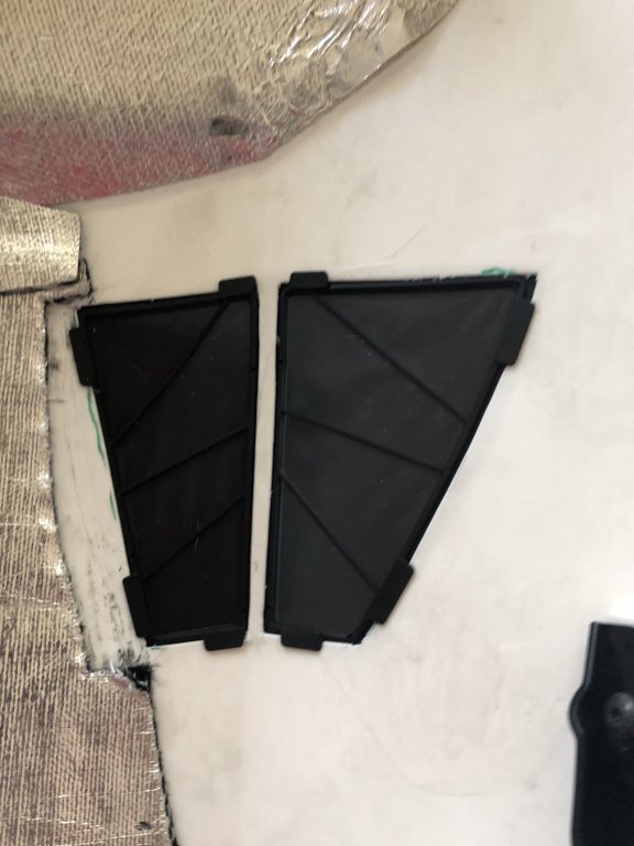

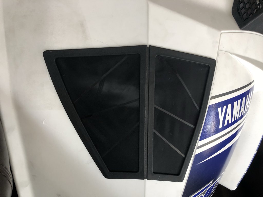

Hi Guys,
Working on the sled in the summer getting a jump on things. Any way I wanted to add some ventilation to both sides of the sled and this is step 1 for the exhaust side, I will be adding some additional scoops to the right front to draw the air in as well what you are looking at is for exhausting air.
The best part about this is the vents I am using are free, well sort of. This will only work for people that have CAI or would like to purchase these vents additionally. I was looking for ways to do this and remembered that under the back of hood near tank fill their were frog skin vents which were used for the stock intake. Since I am using CAI these are no longer needed so took these out and used them for the side venting for both sides. They look good and fit great with some patience. Some pics.
Thanks
Thanks

Nice work
Great thinking!
If anybody is interested these are Part # 8KC-K715E-00-00 and # 8KC-K715D-00-00
