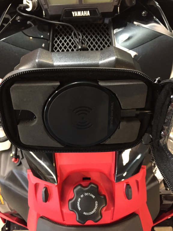

Build yourself a case and QI charger if your phone is setup for QI charging. Even if its not setup for QI charging you can purchase a plug in Qi card to charge. It's how I started with an old 6 or 7 I phone, and the new iPhones are already setup for Qi charging. It works great to keep it warm and charged, and you can leave the trail map up right on the phone if you want and see it going down the trail.
I bought all the stuff from Amazon for less than $40 total as I recall. Works great, I got the idea from here. smartholder-shopping-cart

How do you fasten the case to the top of the riser?

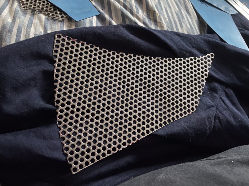

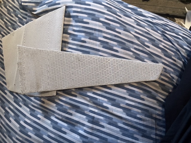

Hello everyone while this was a job and a half lol I tried drilling aluminum but every time I did it warped on me. I finally tracked down perforated stainless and ordered it. They didn’t turn out as good as I hoped but they will work. I would say leave it to the companies that do it lol I included pictures for everyone to see
sidewinder17k
- Jan 23, 2021
- 63
- Peace river
- 2017 sidewinder 162 mtx
Hello everyone. I tried drilling aluminum but no matter how I tried it warped on me. So plan “B” I ordered perforated stainless steel 20gauge. I cut out my vents and wrapped them in phyerex and prefilter on the clutch side. They didn’t turn out as good as I hoped. Oh well. If anyone asks me I would say leave it to the three companies that make them lol. I included pictures so everyone can see
MS
Its a clamp on phone holder for a motorcycle. I drill a hole thru the plastic and clamp it right to the bar smack in the middle. Modified of course for the cheap Qi charger I hot glue into it.
