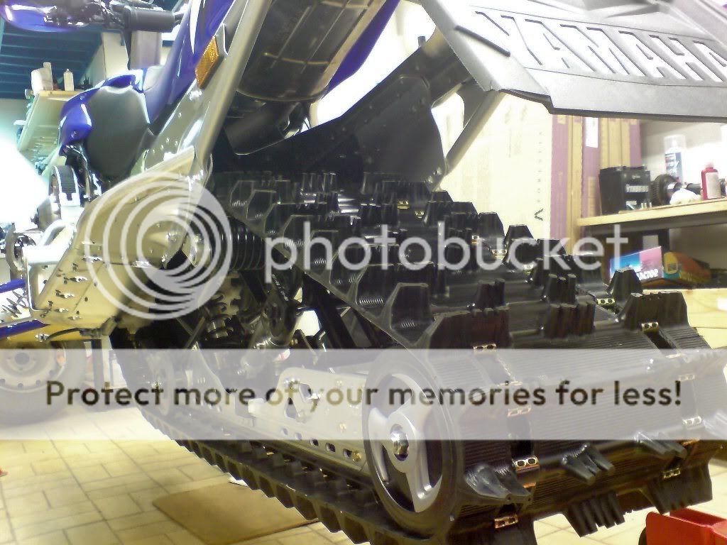

Got the track on yesterday Here you go:

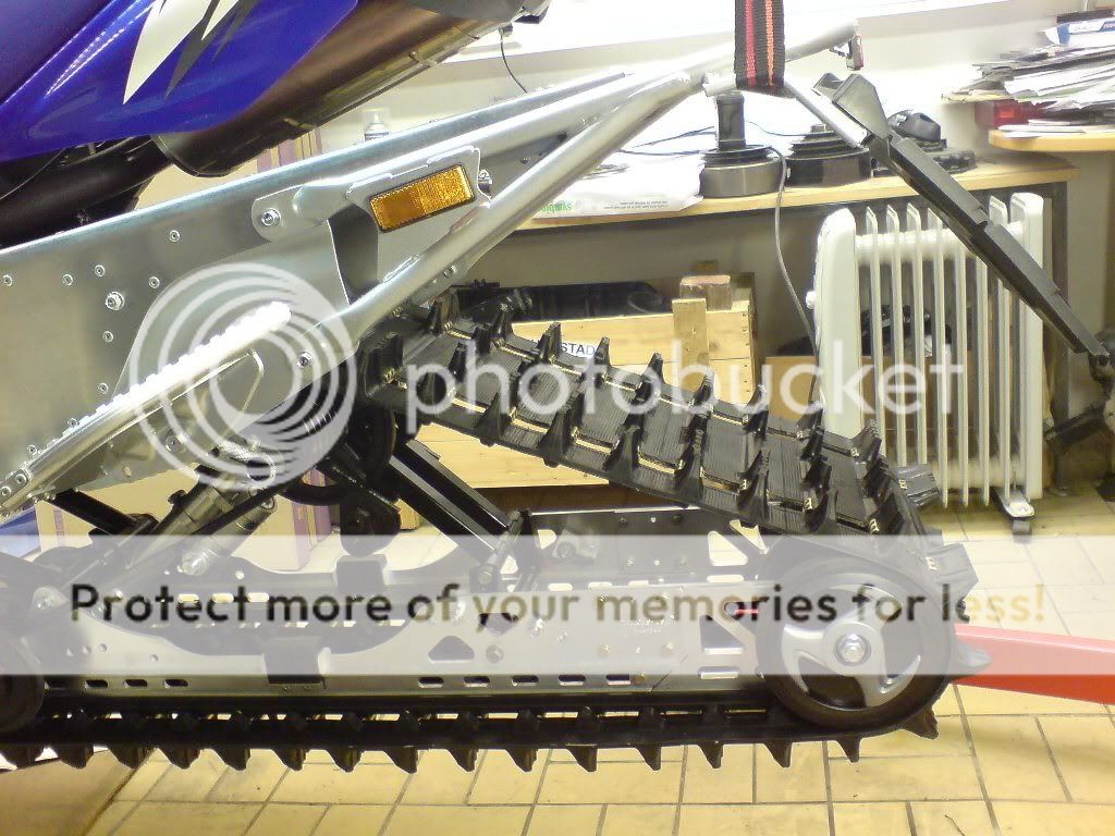

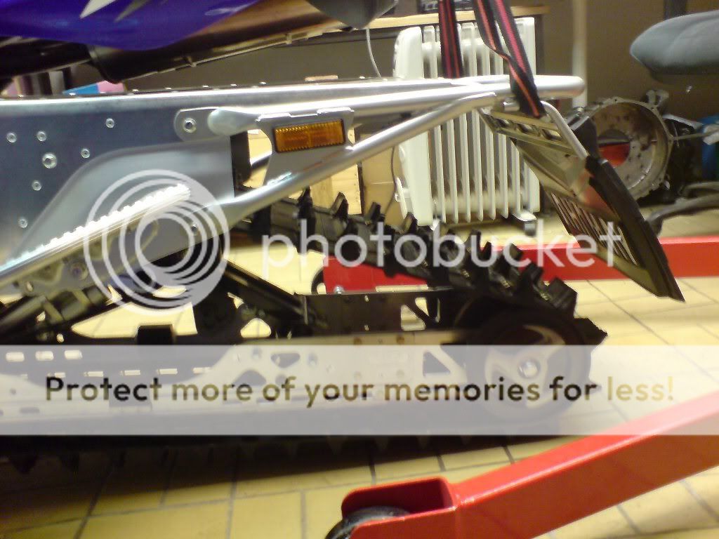

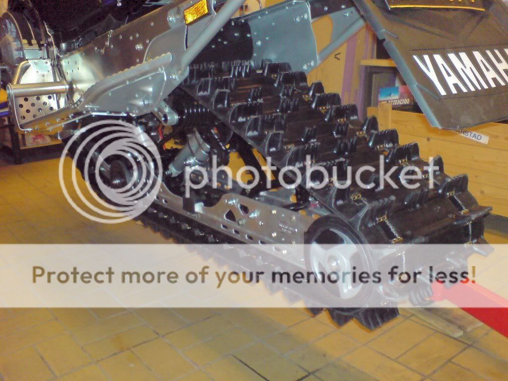

144" Venture RS wide hyfax had perfect lenght (but I have to cut them and the extension when I get the 8" wheels on):
Cut off 15 mm of the rail tips (cut both the metal and the plastic tips to make room for the anti ratchets and the hyfax:
We couldn't get the track to touch the tunnel, we tried 3 men on the sled to bottom the suspension.

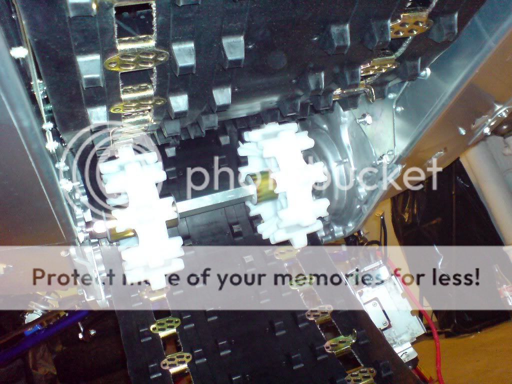

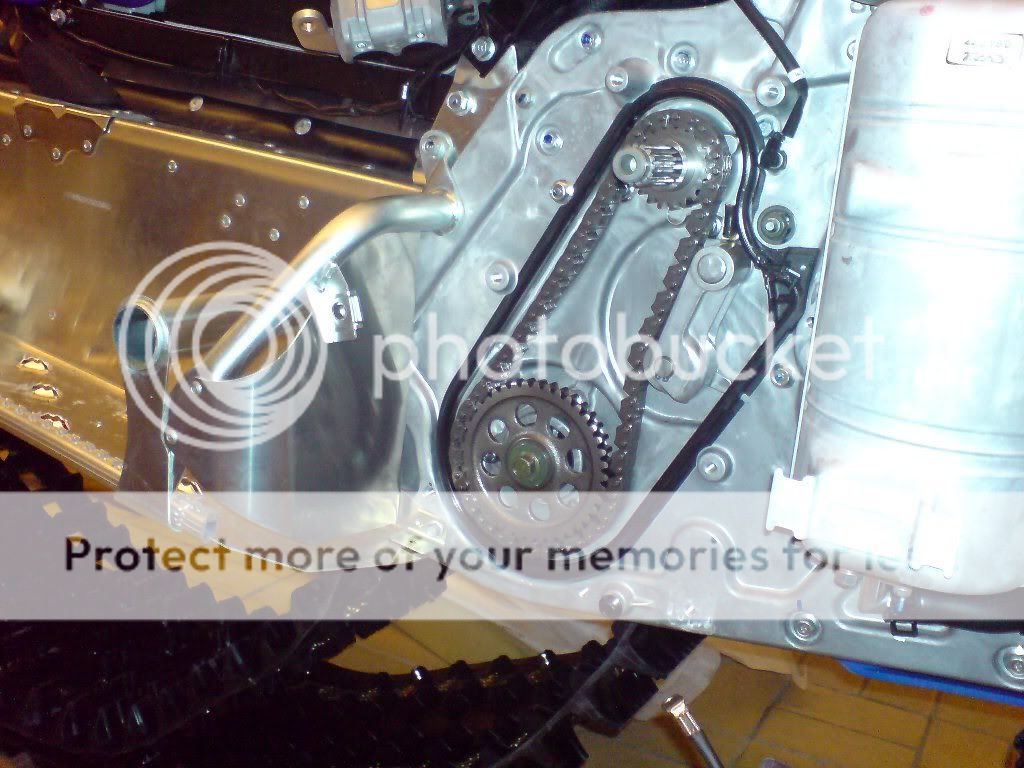

20 tooth top gear:
20 tooth top gear:

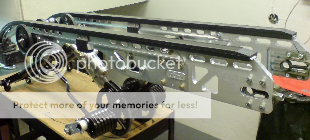

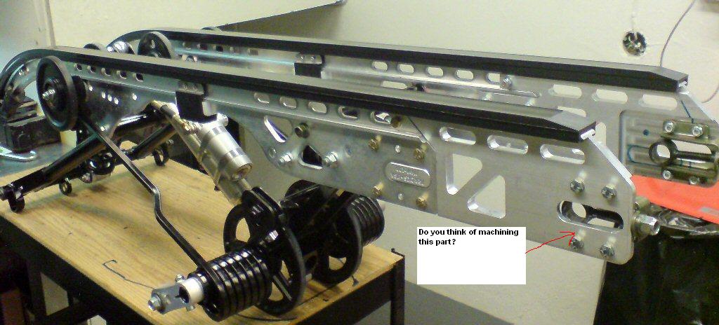

Not to be a smart #*$&@ but I really cant figure out how you could make those 8" wheels to fit without using a offset shaft.
I can see that it is space enough to relocate the shaft forward but how will you do it with the "height" ? It seems like there not is enought alu goods one the rail extension to machine the hole higher up if understand what I meen..
teerex

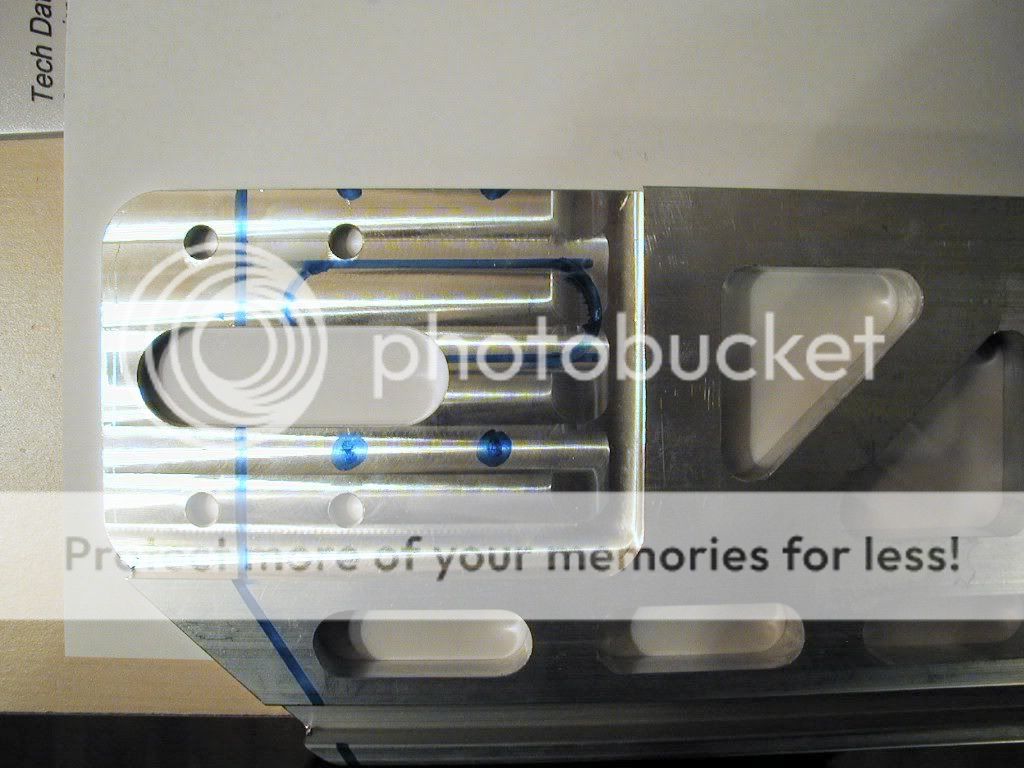

the answer is cutting, welding and drilling and milling and machining
I have talked to a guy who knows that kind of business and he will fix it
This is a quick sketch (you can see it on the inside of the rail in your post):
