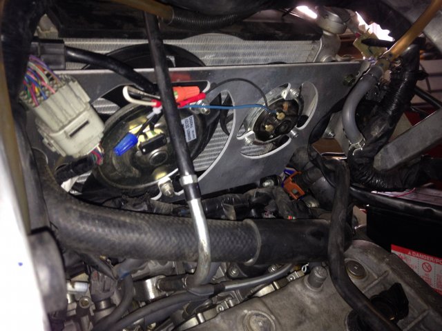

We've got a dual fan set up we are working on to improve cooling. The plate houses the stock fan and adds an apex fan for additional cooling.

Does this kit work with the trail tank and what about a switch to run the fan before 200* +. What's the price of the kit?We've got a dual fan set up we are working on to improve cooling. The plate houses the stock fan and adds an apex fan for additional cooling.
To use the kit with a trail tank you need to have a steering relocate. Fan kits are $125. I also sell relocate kits for $40.
