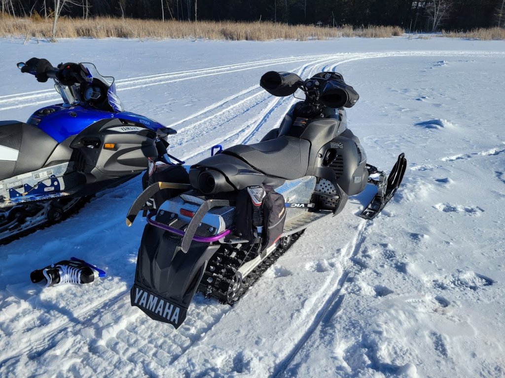

A longer snow flap helps a ton as well

- Nytro, Apex
Are those Canadian ice scratchers?A longer snow flap helps a ton as well
