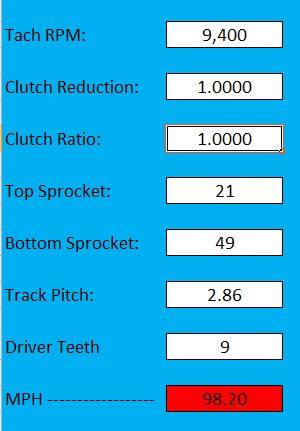

I managed to pull 98 MPH with the 21/49 gears and it gets there very quickly. I'm kinda ok with that... because I'm out of money.
That is best I ever heard! So trueI managed to pull 98 MPH with the 21/49 gears and it gets there very quickly. I'm kinda ok with that... because I'm out of money.

That's awesome, you must be doing something right cause most guys with them gears cant break 88 mphI managed to pull 98 MPH with the 21/49 gears and it gets there very quickly. I'm kinda ok with that... because I'm out of money.
Right! Tell us more. Drivers 9t?That's awesome, you must be doing something right cause most guys with them gears cant break 88 mph
My sled had the rev limiter adjusted from Yamaha's race team. It was a X-country race sled initially. When it was being raced, it had no reverse and 22/48 gears. I was told it did 105 MPH pretty reliably... I have made some minor changes to the clutch set-up to make it a little more trail friendly and put the reverse back in which necessitated using the stock gears again (can't afford new ones right now)
