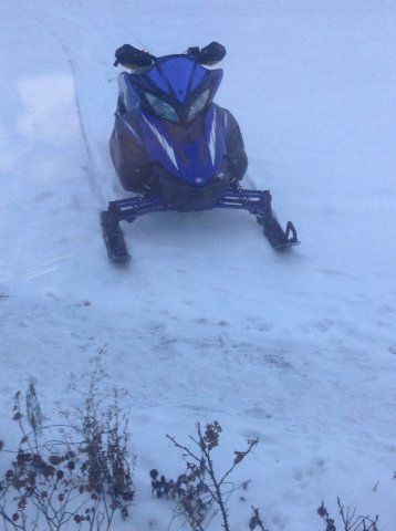

I snapped a photo of my attak with the plastics and windshield off the one I just got, looks pretty good if you ask me.
