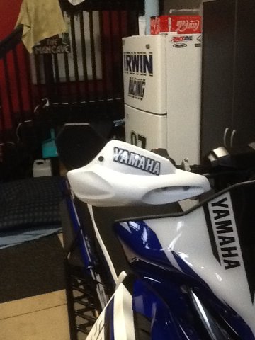

I used my old ones from my Nytro And bought the fold away mirrors that are intended for the power mad hand guards Should do the trick!!!

I don't see why not. They even work with the Cold Guards, which where never intended to have to use a mount. I just wanted a little more stability than the Velcro straps provide.I think I've seen these in the Yamaha parts catalog. Does any hand guard fit these mounts?

I cut off the mountain strap to install the Yamaha/Arctic Cat aluminum mounts. The RTX/LTX snowmobiles don't have that strap, so it's not something that needs to be taken off. The plastic ones mount into the holes on your throttle and brake. They're way too flimsy in my opinion, and the aluminum ones are rock solid (which is obvious).

10-4 on the flimsy on the fiber mounts......I didn't remove grab bar to mount aluminum ones, merely had to trim slightly......maybe 1/4" or so......maybe 1/2", it was last year and don't remember that well......

I never used that grab bar. Left it on for last season, hit a jump and took it right to the chest. Cut it off as soon as possible and put the cover on from a Viper LTX. I think it looks cleaner and lets me run the aluminum hand guards. Yamaha only has one version of the aluminum mounts (it's mountain length, so there's a lot of distance between hand guards and handlebars). Arctic Cat offers a shorter version if you'd like them closer to the bars.
