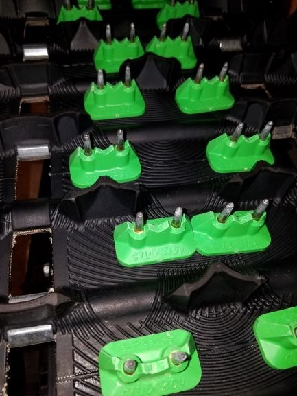

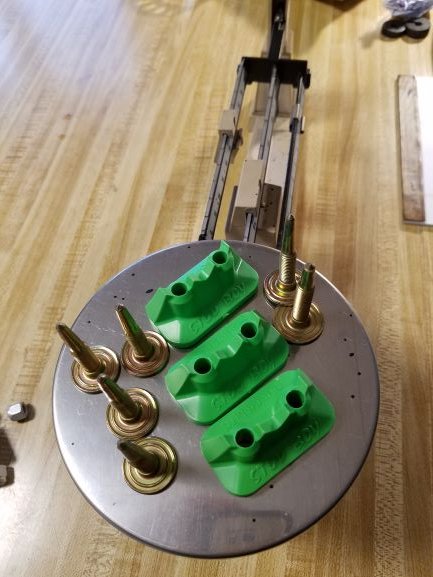

With regards to StudBoy ProLite backers, have you considered using doubles? See pics. More rigid and lighter than aluminum setup. For 192 studs (1.630") Stud Boy Lake Racers and StudBoy double ProLite backers, it's was almost exactly 2 lbs lighter for same number of studs. The way you keep them from stripping is to tap them first. I got this tip directly from StudBoy. Tap them (in my case w Stud Boy studs it was 1/4-28 threads) and then use Professional Super Glue when screwing them in. NO issues with loosening or unscrewing, etc. Locked so good you'll have to heat them to get them out!
- 19
- 16
