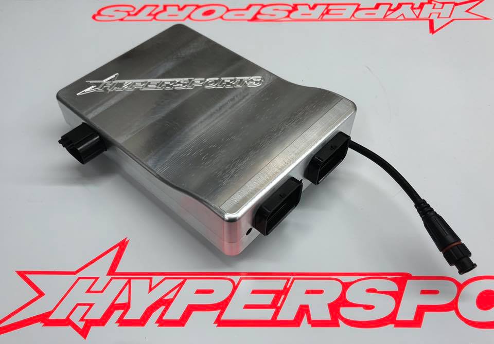

A Hypersports setup is another option too, as they have their own ECU for Sidewinders!
Hypersports 998 ECU
All new Hypersports plug & play ECU for the 998 Arctic Cat / Yamaha turbo sleds.
$2275.00 USD plus shipping
NO JUMPER HARNESS! NO WIRING! NO FUSS!
All of the same features and benefits of the record setting Link ECU, in a waterproof, direct plug in unit, that is suitable for race or trail use.
•Mounts in stock location
•Retains OEM gauge and reverse function
•All inputs and outputs are fully configurable
•Bigger injectors? Bigger map sensor? No problem!
•Full datalogging at 100hz with configurable parameters allows you to analyze engine performance and optimize clutching
•Optional plug and play wideband O2 sensor with no wiring required
•Open or closed loop fuel control
•Open or closed loop boost control
•Adjustable knock control
•Powerful built in igniters eliminate the need for add on ignition
•Expansion port for additional inputs and outputs without having to modify harness
•Switch tunes on the fly
•Limited lifetime warranty.
•Access to Hypersports extensive library of tunes
