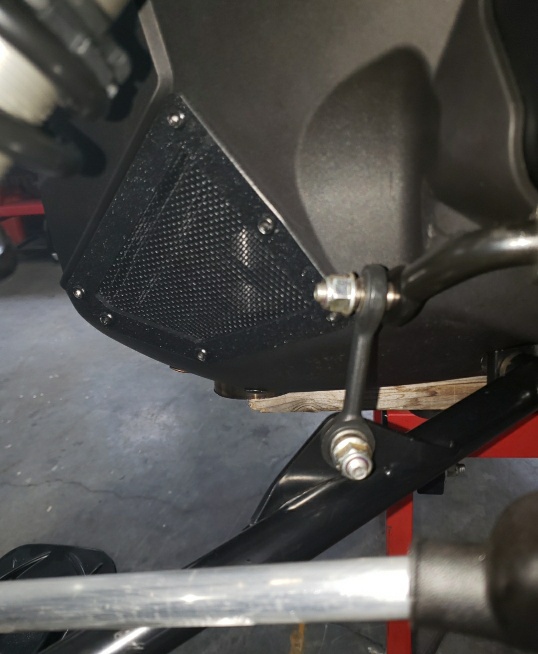

1. The ram air chute plugs the whole hole and blocks off ALL air to the clutches. Using an Ultimax belt will cure all belt issues, but you still gotta let some air in there to cool things off. Having no air come into the clutch compartment is asking for trouble.
2. Air will take the path of least resistance. The top of the airbox is still open, hence air coming in will bounce off the filter, exit the top hole, follow the ducting in the cab, and exit the console in your lap......resulting in cold testicles.
I hate cold testicles more than I love boost!! Just my opinion.....

You can alway add moflow vents for clutchesI really, really, wanted to pull the trigger on this. Im a sucker for more boost and the mention of 2 extra pounds of boost really had me nibbling on the hook.
Heres why I didnt bite;

You can alway add moflow vents for clutches View attachment 154422 View attachment 154423
I was thinking about the same thing yamamarc. Anybody running these moflow vents have input on whether snow dust gets in? Last thing I want would be moisture on the belt, but if the moflow vents prevent that, this might be a great solution to getting airflow in on the clutches.

No, had them since 2012,
Great to hear Crossfire. I may just give this thing a try then for next year and add it to my offseason to-do list.

Frogzskin has all kinds of sizes and shapes. A number of companies sell panel vents like Moflow, etc. The ones I have in the front of both of my side panels I got at SpeedWerx. I also have a number of Frogzskin ones.

0 issues over 3000km on themI was thinking about the same thing yamamarc. Anybody running these moflow vents have input on whether snow dust gets in? Last thing I want would be moisture on the belt, but if the moflow vents prevent that, this might be a great solution to getting airflow in on the clutches.
