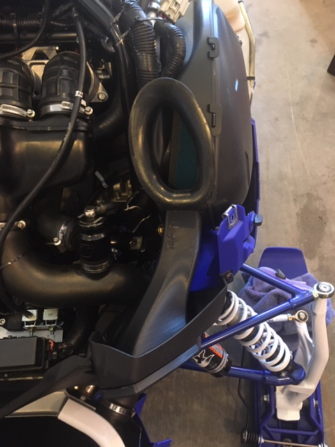

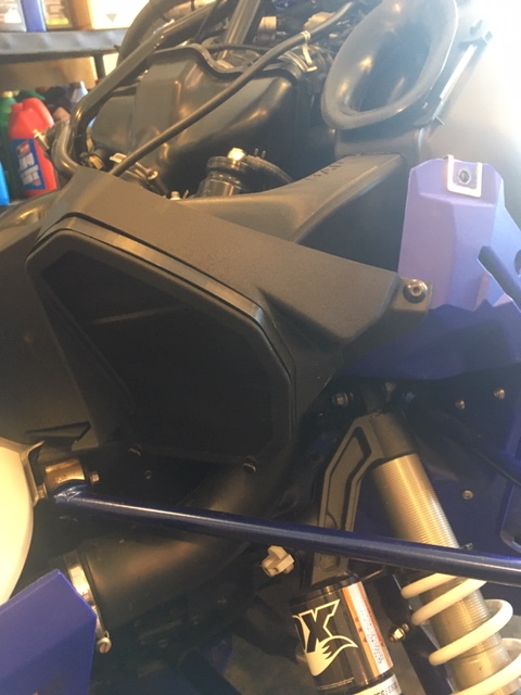

I have the Gap ram air as well as the MoFlow full vent kit on my Winder. The only place I didn't put the MoFlow vents was on the lower side panel on the clutch side as I have the BOP belt guard on that side and didn't feel it would flow any air to the clutches.
I rode the sled a bit with the Gap Ram Air but hard to tell if it helped or not because the sled is already Crazy fast.
I did win the King of The Trail class in our local snow drags with it installed so it didn't hurt!

I think it would be more of a ram air if the stock hole in the top of the airbox was blocked off.
I agree..IMO..its only good for a good supply of cool outside air unless the stock airbox opening was plugged up.
View attachment 154441 View attachment 154442
Are you getting a higher boost reading?
I never data logged it since I installed it but it was slightly overrevving when I was racing it with my no other changes. I honestly would be surprised if it made more boost.
