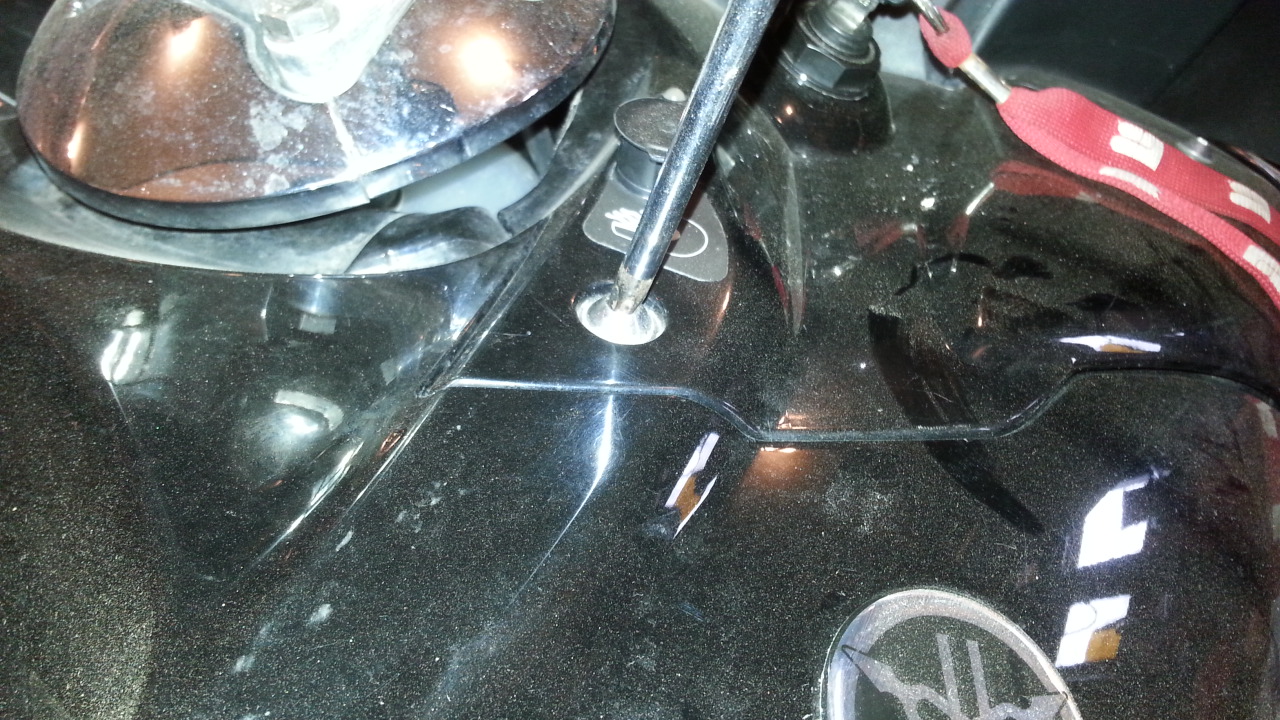

Maybe you guys knew this already, but I wanted to share how I make a quick headlight beam adjustment on my RX / RS:
Use a 5 mm allen wrench or T30 torx driver to loosen the right rear screw that fastens the key switch panel. Wedge the panel open and use a long Phillips screw driver (at least 14" past the handle) to turn the headlight adjuster screw. Remember to carry a small flashlight.
Sorry, sled is covered in shop dirt...LOL!
