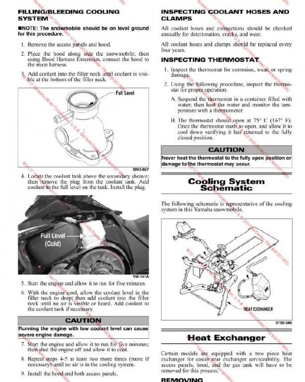

3200 miles on my Winder. Rode Kathadin region last week with hard freeze after mid 30s day and had plenty of limp mode. I know the coolant change worked well on my Attak. Where would I drain the Winder and where is the bleed? BTW we would just take some unplowed roads off the trail and temps would drop quickly to 170º. Cannot idle my sled more than 1 minute anywhere without breaching 200º coolant temp.
Attached is the service manual process. Also there is a 13mm bolt on top of the cast housing next to the ROV on the oil tank side. I also cracked that and lots of air then coolant came out eventually. I do this while the sled was running. Its almost like bleeding a brake, I also drive the exhaust side up on a snow bank when I cracked that bolt. I had tons of air in mine.

Thanks I appreciate it.Attached is the service manual process. Also there is a 13mm bolt on top of the cast housing next to the ROV on the oil tank side. I also cracked that and lots of air then coolant came out eventually. I do this while the sled was running. Its almost like bleeding a brake, I also drive the exhaust side up on a snow bank when I cracked that bolt. I had tons of air in mine.
