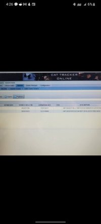

I bought my XF 7000 from a dealer and obviously didn't do enough research as I wasn't aware of the kickback issue until after I bought the sled. My question is: neither of the two recalls have been done. (I think they're both the ECU flash? Not sure but will link pic) Should I get the 2017 flash done? I read about it helping some sleds and making it worse for others. Dealer I bought the sled from is no help and playing dumb to the issue.

I plan on getting a reflash done before next season. I don't ever want to change one of those starters again.I bought my XF 7000 from a dealer and obviously didn't do enough research as I wasn't aware of the kickback issue until after I bought the sled. My question is: neither of the two recalls have been done. (I think they're both the ECU flash? Not sure but will link pic) Should I get the 2017 flash done? I read about it helping some sleds and making it worse for others. Dealer I bought the sled from is no help and playing dumb to the issue.

Ideally I'll get the reflash done before next season too. I'm just a bit confused as I read the reflash was a savior for some sleds, and at the same time caused kickback for sleds that weren't originally experiencing it. Wish the dealer I bought the sled from was more help - if the original owner didn't have any kickback issues I'd probably just leave it but I just don't know.I plan on getting a reflash done before next season. I don't ever want to change one of those starters again.
Unfortunately, the nearest Yamaha dealer is in the Yukon Territory, a six hour boat ride and then 200 mile road trip away. It will certainly cost over $1,000.00 to do this trip, but I think it may be worth it to reduce the chances of having to change out a starter on a Viper again.
Newest flash can make starts a little longer but will never kickback. Never. Do it.Ideally I'll get the reflash done before next season too. I'm just a bit confused as I read the reflash was a savior for some sleds, and at the same time caused kickback for sleds that weren't originally experiencing it. Wish the dealer I bought the sled from was more help - if the original owner didn't have any kickback issues I'd probably just leave it but I just don't know.
