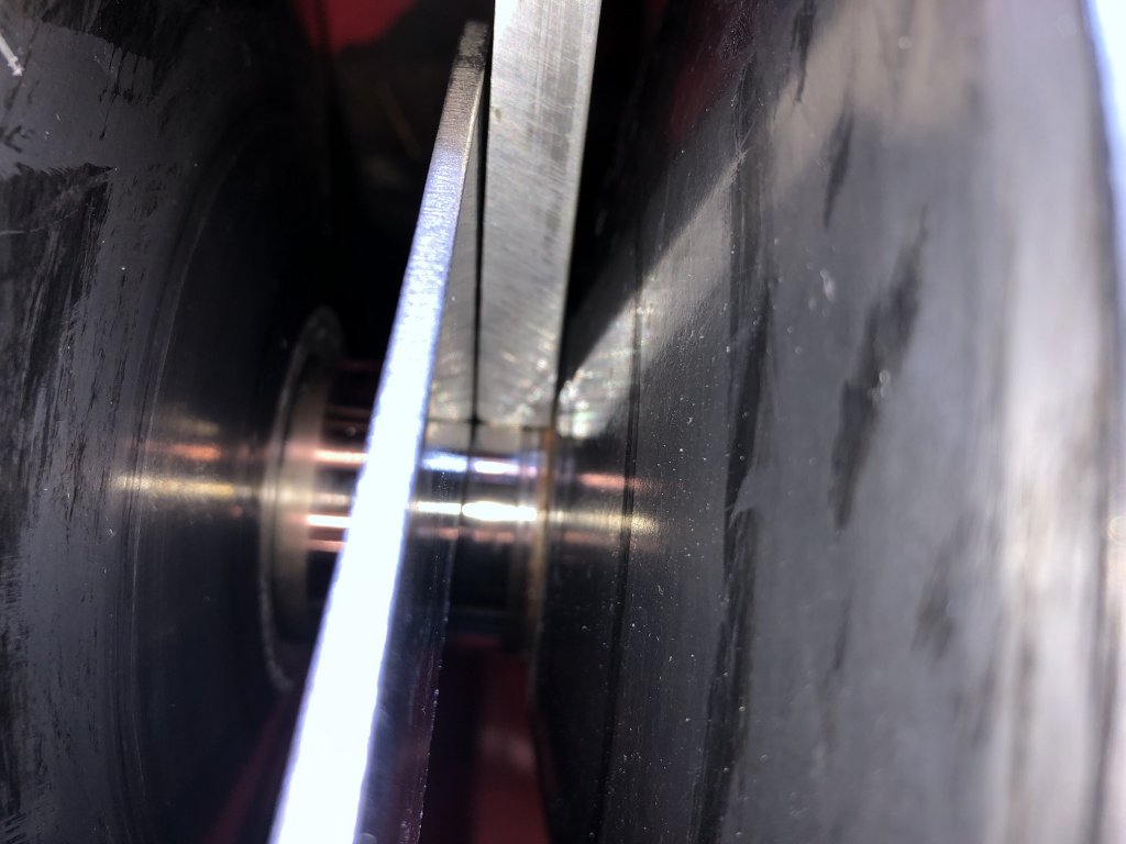

The first picture is the measurement with the tool before machining, no washer behind the secondary but bearing circlip still in. Measured out to a little over 4mm. I wanted to make sure I didn't machine off too much so I got 3mm machined off. The second picture is the tool reinstalled with 3mm machined and I removed the bearing circlip to get the gauge to fit closer. It's hard to tell from the picture but I can still wiggle it maybe 0.5mm.
I'm just debating whether to run it the way it is without shims or circlip behind the clutch or machine another 1mm off the hub and maybe put back in the circlip? I'm a little hesitant to machine more off the hub as when the clutch is fully shifted out its flush with the sheave. (3rd picture)

I'm betting your stub shaft has moved in after blowing a belt or two. Pop the clutch and have a look, you'll see a gap on the housing where the bearing has slid in. If so pop the stub shaft out, clean up and use green loctite on assembly.
You'll need to machine the plug depending on where you end up once you get the stub shaft back where it belongs. (Hint, that its moved), they shouldn't need that much machined off when stub is in proper position! You could end up wearing sheave on bearing housing if you don't get it setup properly.

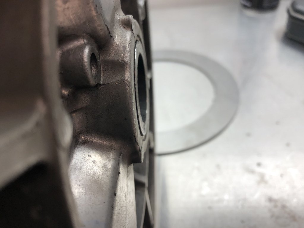

I’ve got it apart now does it look like it moved?
There is no way to press out the bearing on the outside race. If you press out using the inside race would that put too much stress on the bearing?

You can press on the inner race, it won’t hurt the bearing.
