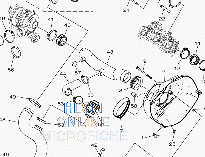

Yes, I'm very hopeful someone comes on here to take lead on this situation.Number 43 in this pic. If I understand Dave's picture the replacement is the left hand side of that tube. Since the diameter is smallest there, the implication is that the coupler or coupler interface is either a restriction or a source of a ton of turbulence leading to inefficiency. The further implication is that Yamaha left 10HP on the table (stock) since that replacement tube has zero effect on emissions, engine health or fuel economy. hrmm indeed.

Anyone that has had that tube off knows it’s very restrictive where it goes behind the steering shaft.

Never understood why they couldn't find a better way to get air from airbox to turbo. Ie - different air duct, move steering shaft (somehow) to get a straighter inlet to turbo.Anyone that has had that tube off knows it’s very restrictive where it goes behind the steering shaft.

Earthling left a diagram. You basically cut appx five inches off the part 43. And replace it with Dave's new and improved turbo tube outlet.
To my knowledge when the factory inlet tube meets the turbo inlet you have like a 2 to 3mm step at the seal, inside the tube
I'm sure all of us agree that seal lip could easily cause turbulence. Thus the reason we port match/gasket match all of our intake & exhaust parts, It's really no big speed secret.
I say kudos to Dave for even wanting to bring this miniscule dollar amount part to market.
Think about it in terms of gross revenue in running a successful business. This part isn't going to keep him fed. Wouldn't even help to pay for the toilets when they're being flushed.
5/10 ponies plausible?!?! It sure can't hurt you.
