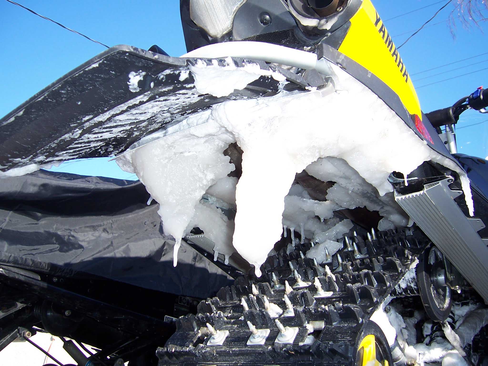

An update and it looks like the problem is solved (although not exactly the way I wanted to do it...).
Today I put another 300 miles or so on. At first the hyfax was running too hot as usual. The hyfax and skid was basically running with no snow accumulation at all and I could feel the hyfax dragging a little every now and then. Basically it was on the verge of overheating.
The trails were hard packed, but the rock hard base left by the groomers of a few days ago had been broken up a fair bit by all of the studded sleds running on it. Lubrication should have been decent.
As an experiment I decided to bend the snowflap down a little. Right away I noticed a big improvement and there was no more dragging sensation.
Halfway through my trip I was trying to get to my cottage and I came to the end of a closed trail (annoying - now there's no way to get there...). While trying to turn around on the narrow trail I ended up backing up on the snowflap (studs caught it) and this bent the snowflap mount down quite a bit more.
After this the hyfax ran perfectly cool for the rest of the day - so much so that snow was building up on the slide rails and the sides of the hyfax when riding on the exact same trails that had left them bare just a little earlier. Temperatures hadn't changed either so the snowflap was definitely the only change.
Looks like I'll be leaving the snowflap pointing much more downwards instead of the stock almost 45° angle it used to sit at.

I can now say that my hyfax wear is 100% resolved. Over the past two days I put on well over 1000 km, much of this in very low snow conditions (including refrozen solid ice trails), and my hyfax still has almost 12mm of thickness.
I tried it with the snowflap back up on one railway bed and immediately the hyfax started to heat up, drag and smell. Bending it down and they ran cool again.
There must be just enough ice chips thrown up by the studs/track that with the snowflap down the chips hit it and get blown around the tunnel and skid, keeping things cool.
I also noticed with the flap down that the radiator fan doesn't run as much. With it up, the fan was running most of the time (and had been most of the season), but with it down it only came on in the absolute worst conditions.
I don't know why others aren't having the same issue, but most likely my situation was due to a combination of things including the 1" track that I'm running (I suspect the Ripsaw gets more snow caught in the tips of the lugs and throws it in the tunnel more), the taller ride height (I'm running with only 3" of sag at the rear bumper which you can't get with stock springs), and the local snow conditions (most of my riding was in very cold temperatures with only a couple of inches of base).
The other puzzle is why my 1" track was ratcheting so badly that I either needed the track tighter than spec or needed to install anti-ratchet drivers when many others with the stock Ripsaw aren't having ratcheting problems.
