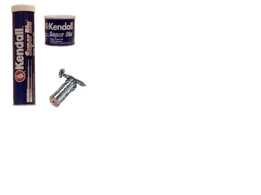

I use Kendall Super Blu for my skid-suspension, trailer wheel bearing buddys, PTO and jackshaft bearings as well as my idler wheels. Comes in a tube for your grease gun and a tub for adding to bearing packer and palm grease gun with needle. Just use a pick and remove seal and add grease into cage/race area around ball bearings.
