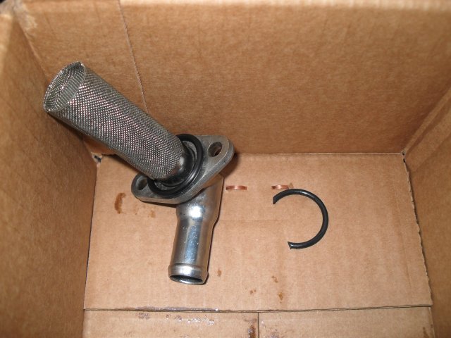

I found this advice to be perfect and used this exact post to do my oil change. I would only add one thing. In my experience, when I did my 09 NYTRO XTX I ripped the o-ring for the screen housed in the elbow fitting (#4 on this post) I tried to wiggle the screen out, not knowing that the thing is 2" long. The easiest way that I found is to back off the bolt on the bottom of the oil tank (this allows you enough room to take the black hose off the elbow fitting without the hose kinking and possibly damaging the o-ring). Use a pliers to remove the clamp on the oil hose then remove. Now... here's where I ripped my o-ring. When you reassemble your elbow fitting o-ring be sure to put the o-ring in the groove on the elbow fitting first, use a little oil on the o-ring so gravity doesn't kick your #*$&@, then gently mate the elbow fitting to the oil tank, then tighten the two allen bolts evenly. (I left the o-ring on the screen housing then tightened the two allen screws and ripped the o-ring unknowingly, started the sled and dripped fresh engine oil to my shock, grabbed an empty coffee container and saved the new oil) I will try to post a pic of the old o-ring and the new one on the screen. P.S. I just bought this sled and don't have a mile on it (it has 1,619 on it) I discovered this site and absolutely love it! You guys are awesome! Thanks, JoeWow!

4.) Carefully remove the gold color elbow fitting from the bottom of the oil can. There's a screen that should be cleaned. I would do this after break in and then at least once every two years. I do it every time. Carefull not to loose the rubber O-ring in your drain pan. Clean/Reinstall

Never again will that screen and elbow get removed from my nytro, for as long as I shall own it!
I had to replace my o ring also, and my screen mushroomed out and was next to impossible to get to go back in the hole!
