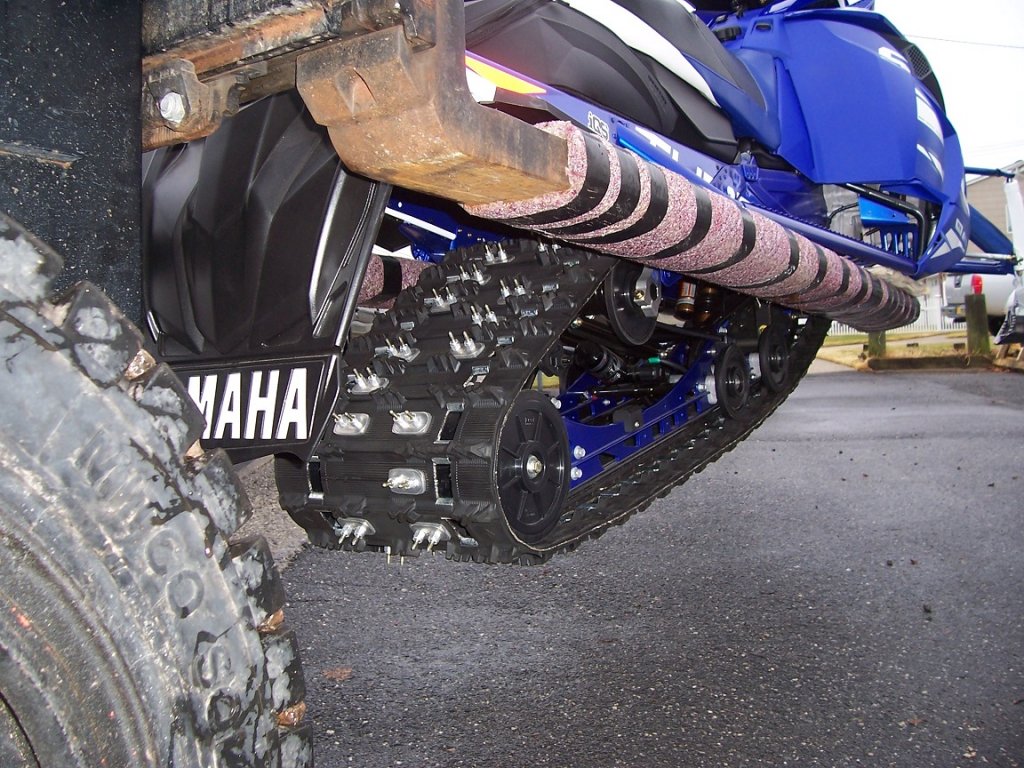

Over the years you hear a lot of "talk" about "aggressive" riding,,, then you look at their track and you see all single backers,,, then you ask them how many studs do you rip out,,,, then they say oh i never rip out studs. Moral of the story, If youre not ripping out single studs, you arent as an aggressive rider as you think you are. If you are an aggressive trail rider and you stud the outside and get a ripout, your track is pretty much garbage. all it takes is 1 rock. and pray it doesnt take out your heat exchanger at the same time. studding the center if using singles, if you do get a ripout, you most likely can continue to use the track. Using all doubles definately reduces the risk of a ripout substantially.
